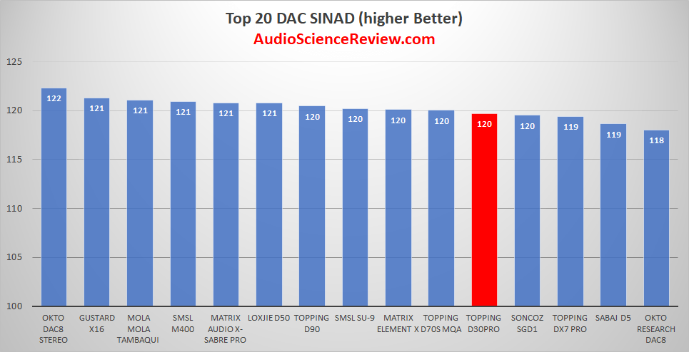

If you are set on your planned path, since you have included two very nicely prepared block diagram, I would spend some time on them and get back to you later.
Example:
Topping D30Pro Review (Balanced DAC) | Audio Science Review (ASR) Forum

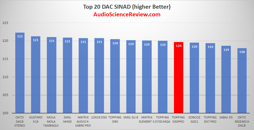

Example:

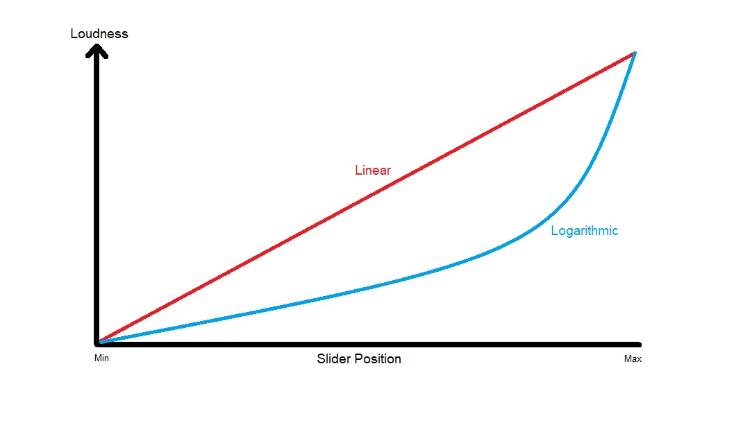

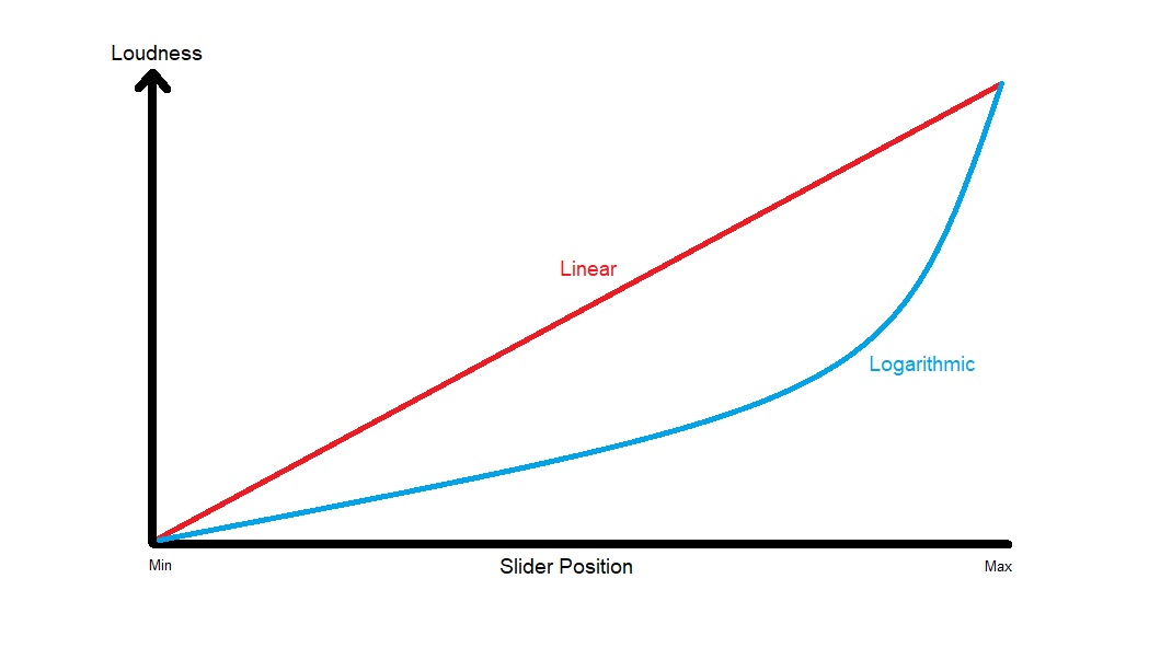

Volume control knob position does not tell much, other than in general you would try to avoid turning it higher than 12 O'clock, but it really depends on other factors such as the input signal voltage that in turn depends on the kind of device upstream and the source media contents obviously. It also depends on whether the volume control follows a linear scale or log scale? I think most vintage integrated amps would have the linear one. Your A9010 isn't that old and it use an IC to do the job, so I think most likely it has a log scale characteristic.
If it is log scale, you will notice that the level would increase more gently as you turn it up but will increase more rapidly (more sensitive) as you keep cranking it up.

That preamp, to me, is a low cost nice toy, but if your goal is transparency, neutral kind of "sound signature", then yes you are better off with an integrated amp, AVR, or a stereo receiver.
