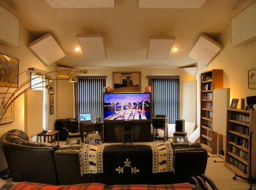

Ethan Winer
Ethan Winer
Mike,
> what is the quantity of bass traps that is equivalent to too many bass traps in a room - that will start to mess up the mids and highs? <
It depends entirely on the type of bass trap and its "curve" of absorption versus frequency. As I said, I have 40 of them in my living room, and it's not too much at all. But that's not necessarily the case for other types of panels.
If you've never seen my living room with 40 traps, have a look at the photos below. :eek:
--Ethan
mike c
mike c
wow.
since you have access to the stuff (e.g. real traps) how come you don't use bigger - thicker - blockier bass traps? or does the diminishing returns kick in after 4-6" thick?
Ethan Winer
Ethan Winer
Mike,
> wow. <
Yeah, and it sounds great too. Most of my friends are professional musicians and/or audio engineers, and they're always amazed at the sound quality. Especially considering that most of my electronic gear is mid-level consumer stuff.
> since you have access to the stuff (e.g. real traps) how come you don't use bigger - thicker - blockier bass traps? or does the diminishing returns kick in after 4-6" thick? <
Not sure if by "use" you mean use or manufacture. We do have two models that are 4 inches thick, and I have a few of those in this room. But most of the traps are 3 inches, and they do a great job. One trade-off is the physical size FedEx and UPS will handle. We're right up against the "Oversize 2" limit now, so if the shipping boxes were even one inch larger the cost would jump considerably. But six inches thick isn't needed anyway, at least the way we make them.
--Ethan
