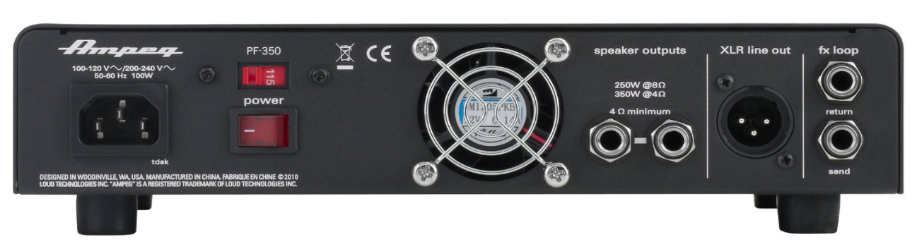

Good day!
I'm a bass player and I recently bought an Ampeg PF350 class D amp head and I want to build a cabinet with Eminence equipment. I'm able to make a baltic birch plywood cabinet in my work (we got a CNC and we use these kind of plywood in daily basis) so that would be the easy part for me, however I'm not familiar with driver units, crossovers and the whole nine yards (although I know what are they for).
Since my amp head delivers 350W @4 ohms and 250W @ 8 ohms, the first thing that comes to my mind is to get a 4 ohms 12 or 15" driver so I can put all the power in just one driver (would be great to squeeze all the power through just one driver so my gear won't be unnecessary heavy and roomy. I'm also thinking on getting a 450 - 600W rms driver thinking ahead on getting a more powerful amp without having to get a new cabinet.
One thing that I know is that the sound that I'm looking for needs also a supertweeter (like many brand bass cabinets) so I can get a nice low end response while keeping brightness, but while surfing the Eminence webpage I only can get 8 ohms supertweeters, so at this point I don't know if I'm looking for a nonsense, so here come the questions:
1. It would be possible to get a nice combination of crossover and supertweeter able to work in a cabinet with a single 4 ohms driver?
2. If no, that means that I have to go for a cabinet with a couple of 8 ohm drivers so I can get a supertweeter unit?
3. If anyone os familiar with this, could you suggest a crossover for this usage?
BTW, I was looking for this Eminence driver models:
KAPPALITE 3012LF-4
DELTA -12LF
DELTA PRO 12-450-4
DELTA -15LF-4
KAPPALITE 3015LF-4
This is the rear panel from the amp head that I got.
Thanks for your support!
markw
If you run two eight ohm supertweeters in parallel, it will be seen as a four ohm speaker.

Since you did ask specific questions, I'll take a stab at answers.
Yes, a crossover can be made with a 4 ohm woofer and an 8 ohm tweeter. But before you pursue that, think about some different options.
Instead of one large 12" or 15" woofer, consider using two smaller 8" or 10" woofers. If you get two 8 ohm woofers, they can be wired in parallel making it a 4 ohm load for the amplifier. Two smaller woofers offer several advantages:
  1. They can put out as much volume as one larger woofer, with less distortion.
  2. Smaller woofers are capable of higher frequency sound than larger ones. With that you might not need a tweeter.
Obviously, smaller woofers may not go as deep as a larger one, but frequencies below roughly 40 Hz may not be the major concern for bass guitar.
