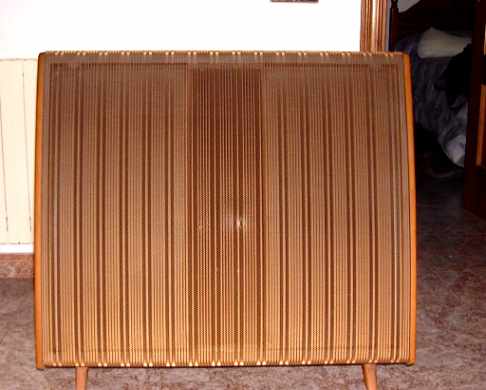

The point is that NO bookshelves have deep bass. A sealed enclosure is absolutely no guarantee of a non resonant bass, as there is always a varying degree of ripple before roll off, sometimes quite extensive.
This is the only bookshelf speaker that I am aware of that will solve your wife's problem.
Most audio enthusiasts come to tune this problem of resonant bass out. I probably could not live with any members systems here for this reason. That includes our illustrious leader.
This problem was realized early in the post war II Hi-Fi boom. That led Peter Walker to develop the landmark ESL 57. Introduced in 1957.
The speaker had serious power limitations, but it was accurate beyond anything heard before.
So there was a rush to try and develop moving coil speakers to have much less bass coloration. This led to the formation of the Radford research group, many famous pioneers were closely involved, and many heavily involved on the periphery. I had the good fortune to personally know and learn from a number of these guys. The upshot was the development of the aperiodically damped transmission line speakers. The pinnacle was the development of the triamped monitors for the BBC studio at Maida Vale. There have been a number of successful designs over the years, especially from John Wright of TDL.
The problem is that these speakers for extended bass are large, the construction complex and costly. The other issue is that there is a relatively narrow range of driver Thiele/Small parameters that are ideal for TL loading.
I have been building speakers based on the work of this Radford group and George Augspurger's work while at Harmon. A design model I received from him, can be downloaded from my website, which can be used without restriction.
I maintain your wife does not tolerate resonant reproduction and nor do I. I think many women are actually in that boat. That is from my personal observation. So I think your wife's issue is not deep bass, but resonant bass.
