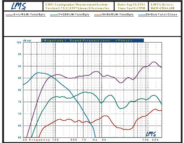

The CM1's response curve is far from the ideal flat curve. In fact, there is a prominent dip in the range from about 1.3 kHz to 5 kHz. Across that range, the CM1 speaker is much less sensitive than B&W's stated 84 dB. That may be the answer to your question.
I found a different curve for the CM6 (http://www.soundandvision.com/content/bowers-wilkins-cm6-s2-speaker-system-test-bench ). See the purple trace below. It can be hard to compare frequency response curve done by different people, but for comparison, the red trace is the CM1 s2 speaker. I'd sooner believe the SoundStage curve.

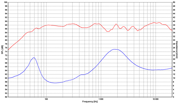

I couldn't find a frequency response curve for the original Dynaco A-25, but I did find a curve for the Madisound's modern "clone" of the A-25, the A-26 Kit. Frequency response (on-axis) is the red curve, and speaker impedance is the blue curve. I don't know if the A-26 is representative of your A-25s, but this curve is clearly flatter across the mid range than either of the B&W CM speakers.
