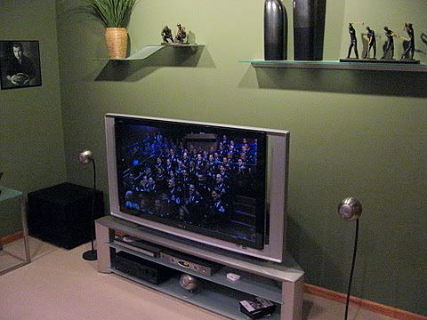

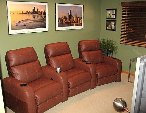

Following are a few images of the original set up. I posted these same images before and subsequently made a few changes based upon input from the forum. I moved the seats 18 inches away from the walls. I moved the center speaker to the top of the television. And, I moved the subwoofer away from the corner walls.
Entering the room--it's only 10 feet deep by 13 feet wide...

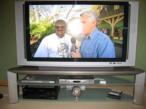

View of the subwoofer, front and center speakers, television and other components...
Television and stand with components...

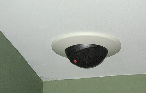

The Anthony Gallo Micros are positioned in the ceiling...
