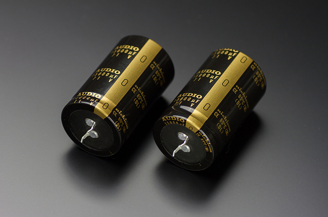

It's a gimmick for most all use-cases. Electronic components are rated to a specified lifetime in operating hours at a given max temperature. For an electrolytic capacitor, the rated temperature is generally 105C, and you will see a rating for a number of operating hours (say 5000, for example). That lifetime then halves or doubles +/- every 10C. So a capacitor rated to 5000 hours at 105C will last 10000 hours at 95C. The AVRs I've seen tend to max out in the 80s, so even at 85C, that's 20,000 hours or over two years of 24/7 continuous operation. At a more realistic 4 hours/day of operation, that's over 13 years!
As the poster above noted, your AVR is going to be long obsolete before 13 years.
Not sure that cap rating of 105C is that common in an AVR. For instance, my 2015 year model Denon AVR-X4200W uses large caps rated at 85C and I don't know the rated life. It does get toasty inside an AVR.
