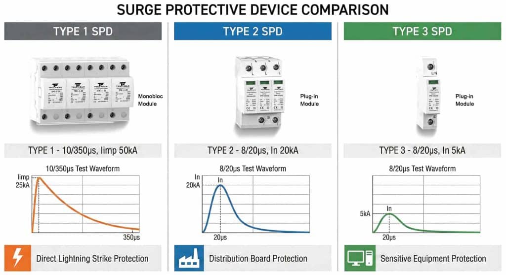

BTW- Type 3 ARE recommended but can't be used as stand-alone protection-
The IEC guide was very helpful, Thanks! . I have an Intermatic power guard outside at the service entrance. The sticker has SCCR:50KVA, In 20KVA. It is listed as both type 1 and type 2. Based on the IEC guide it looks like SPD 2 should be installed at the inside panel box which I don't think it has. So the current installation relative to the guide is a little confusing to me. I was using a panamax SPD device.
At entry by Spec. you have SPD-2. So it does not meet current NEC. So you need an electrician to install SPD-1 at entry and SPD-2 at your panel or panels.
