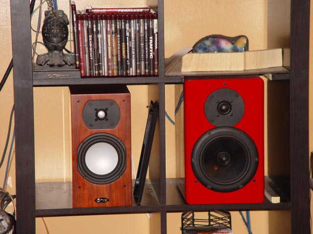

I'm planning on buying a pair of speakers in the X-series line, and I'm deciding between the bookshelves (x-ls) and the towers (x-sls). I've seen many reviews of the x-ls but none of the x-sls. Are they basically the same speaker? I'd like to buy the bookshelves and place them on an enclosed bookshelf (enclosed on three sides other than the front, of course, but plenty of room for the speakers on those sides), but I'm hesitant because I'm worried that placing them there will affect the sound. Does anybody have any experience with the x-ls situated as such?

Yes they are basically the same speaker internally, however the larger cabinet allows the tune to be lowered quite a bit from 55Hz to 45Hz.
The X-LSs are rear ported and they don't like to have a wall close behind. I had them about 4 inches from the wall and it did affect the sound for sure. Placing a bookshelf in a small cabinet will always have an effect on a speaker whether it is ported or not, but rear porting is probably the worst combination.

I have got mine in a tiny bookshelf and they sound great. I do listen to them crossed over at 80hz because they are part of a 4 X-LS 1 X-CS 1 X-sub 5.1 system but they sound pretty good.
Granted they will sound better out of the shelf but you gotta do what you gotta do sometimes!!

I didn't mean to make it sound like they will sound like crap, just that it is not an ideal situation. :)
