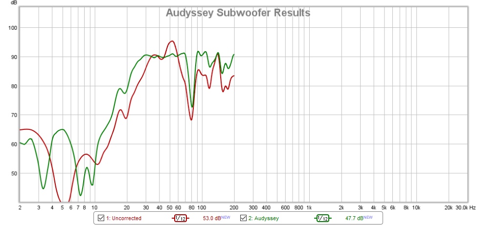

Audyssey XT results.
Y
yepimonfire
Looks like the flat setting is more appropriate for my room due to the fact my speakers have fairly constant directivity (therefore the off axis reflections aren’t rolled off like would be with dome tweeters) and my room is moderately treated. The high end is still just a tiny bit down compared to the direct measurements, but it’s likely not that noticeable. The subwoofer results are excellent. Nothing can be done about that narrow 80hz notch, it’s simply due to my listening position.”, and in reality, isn’t audible with real content. Crossovers seemed to be set appropriately. It set my front three to 40hz, I’m not sure if it actually measured a 40hz rollof, or if the receivers lack of a 50hz step between 40 and 60hz defaulted it to 40hz. I’ve usually measured a 47hz f3 for the l/r and a 50hz f3 for the center. Might set the to large and see what the measurements read with Audyssey enabled.
Suggestions, comments, or complaints welcomed.
Listening tests in progress...
Y
yepimonfire
Music test:
Been listening to some AC/DC for an hour or so.
I did have to change the distance settings a bit, I must not have perfectly centered the mic, I know for a fact my speakers are all exactly centered, within fractions of an inch. It originally measured the right side being about .2 ft farther, I have I the benefit of the doubt initially, but definitely heard an image shift sitting in the money seat. I changed the distance settings up and down one notch respectively to match. Also did some modification to the level settings by ear, lowered the left right, Surround, and height 1-1.5dB each. They always sound slightly louder despite not measuring louder for some odd reason. Sounds pretty balanced now.
Listening first in stereo, then switching to 5.1.2 via DSU, the first thing that really stuck out to me is an exact timbre match across all 7 speakers. My speakers aren’t really mismatched terrible per day, but my heights are from the Klipsch Reference II series, and surrounds from the “cheap” reference series (r-15m). While all speakers do have a similar Klipsch voicing, the front three are near studio monitor flat, extremely neutral and revealing, while the rb-10s up top are a bit brighter sounding, and the R-15ms just sound “different” since they use an injection molded graphite woofer and aluminum diaphragm vs cerametallic woofers and a titanium tweeter. I’d also say 99% of the time, an mtm center paired with a TM bookshelf or floor speaker, is never going to sound 100% identical to the l/r. With Audyssey flat, all speakers blend seamlessly and perfect. I quite like it .
The timbre is slightly different from the direct setting, however, I almost prefer the Audyssey flats timbre to the uncorrected. There’s almost a better “focus” and the soundstage is noticeably more coherent. The benefits of Time domain correction are clearly apparent.
Bass sound perfect.
Overall, I think I will keep Audyssey flat on for now. I might actually utilize the reference setting on some movies since films that haven’t been remixed for bluray using a “near field “ mixing technique are too bright due to the xcurve calibration for a large sub stage or cinema. Overall I’m highly satisfied.
I do wish the app didn’t have so many issues. The most annoying issue with it is that it always rolls my sub off at 30hz. Modification of the target curve doesn’t fix it either. It seems the act correctly recognizes the 23hz f3 of my sub.
Also remeasured the fronts, and I was correct, they roll off at 47hz and 55hz respectively, and so I have set the xover to 60hz

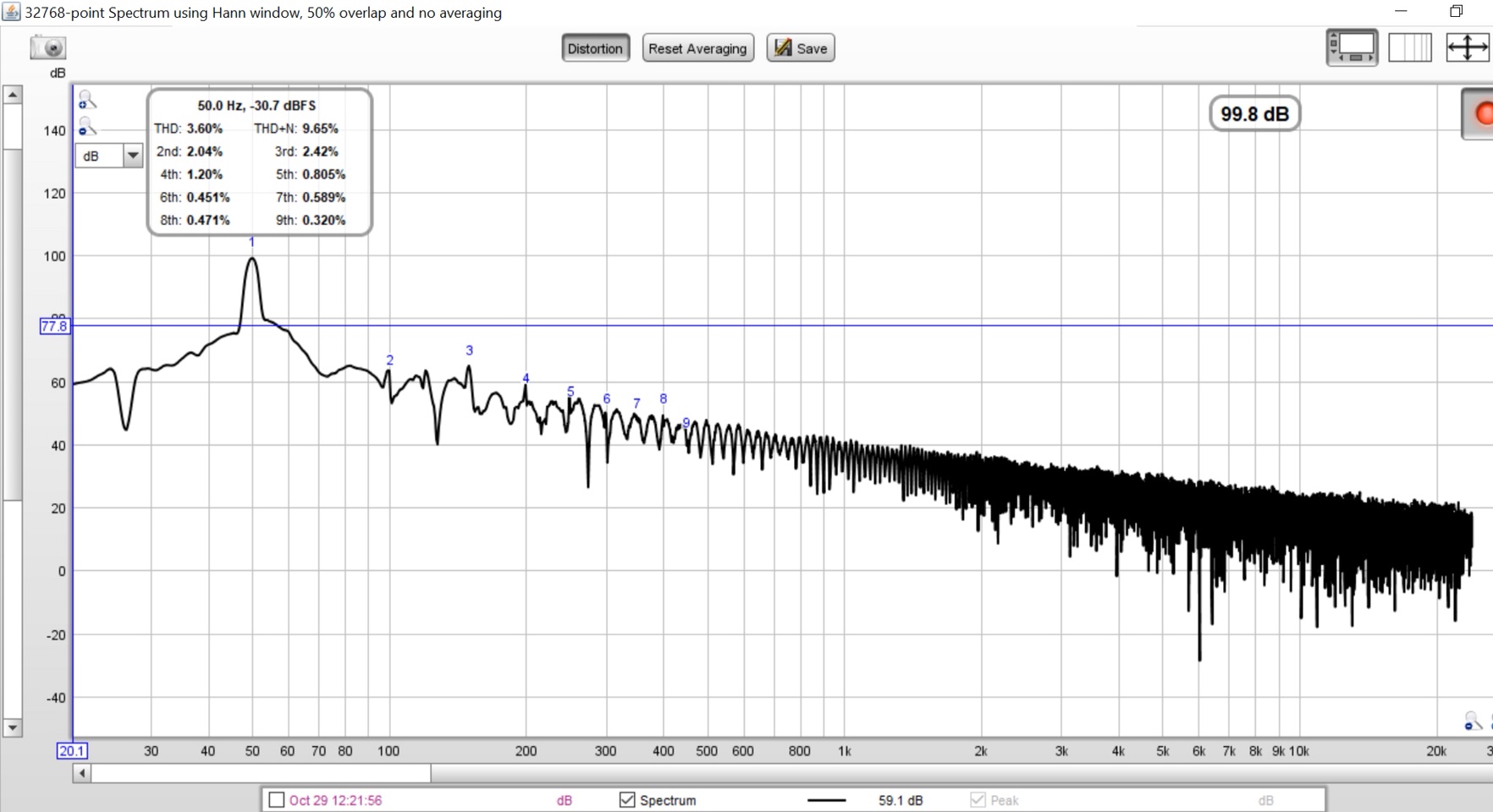

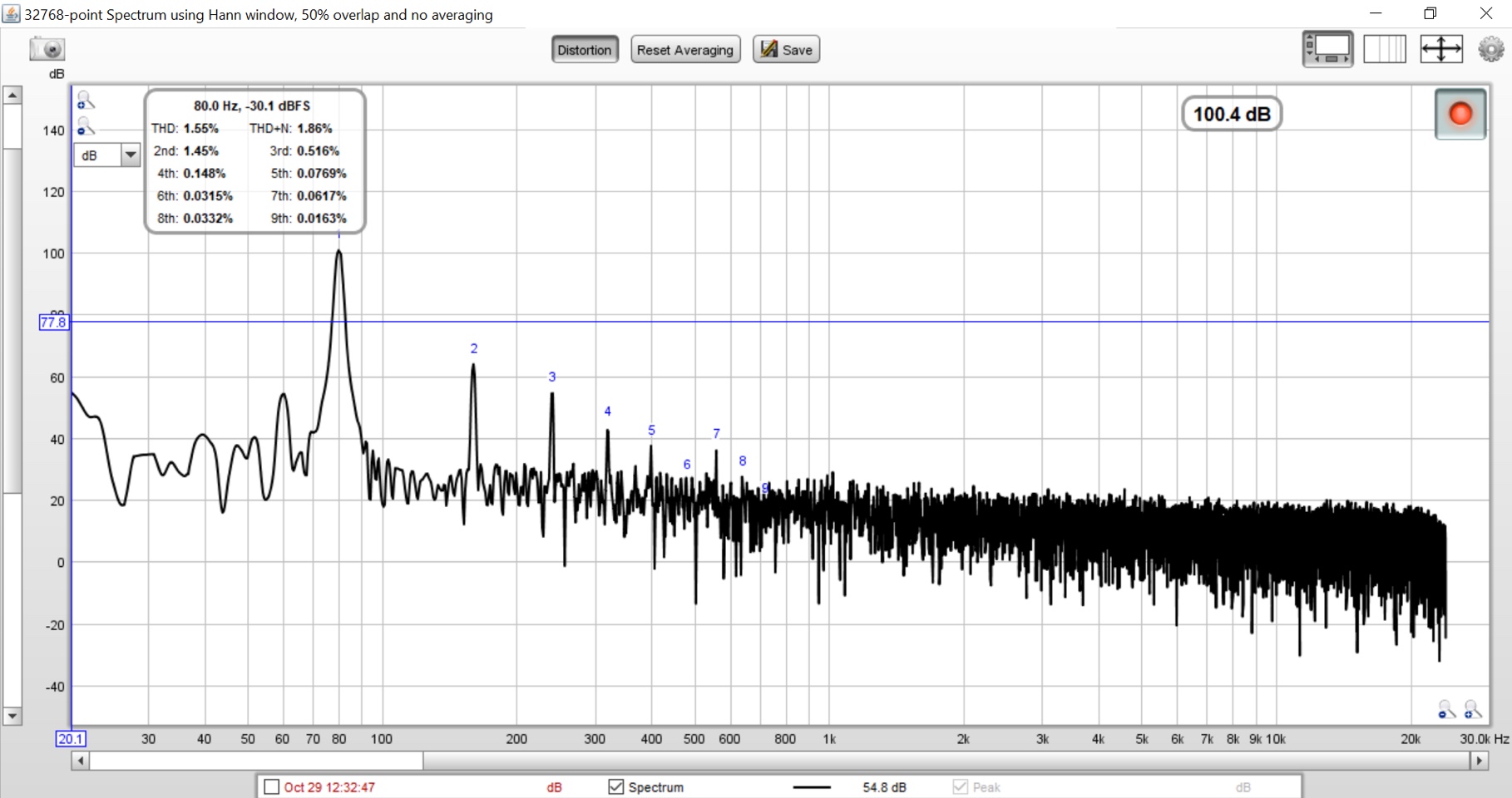

A 60hz xover has always sounded great to me, as it measured flatter, my fronts have very good midbass reproduction, even at stupidly high spl, and sound better than the sub, even with Audyssey enabled. I’m not worried about distortion or stressing my mains at such a low xover either. My front left and right are capable of 100dB @50hz in my mlp 11’ away with 3.6% THD. My center is capable of 104dB @50hz with 2.8% THD. at 80hz, THD is 1.6%.
My subwoofer is incapable of exceeding 105dB at any frequency between 30hz and 50hz without exceeding xmax and whacking the pole piece, at a volume of -10dB on the avr, that means my front l/r have 5dB of headroom in the bass, and my center has 9dB. I did read pogres thread, I’ve had much better results with the avr vs the app sadly. Originally, I wanted to use the app to disable correction above 300hz, but this experience has shown me that wideband correction actually sounds better to me, and IIRC the midrange compensation is disable on the flat setting, that was another issue I was worried about, since it assumes a 2khz xover, and my fronts are crossed over at 1.5khz, surrounds at 1.8khz, and there is no directivity mismatch, seeing they are a constant directivity design.
