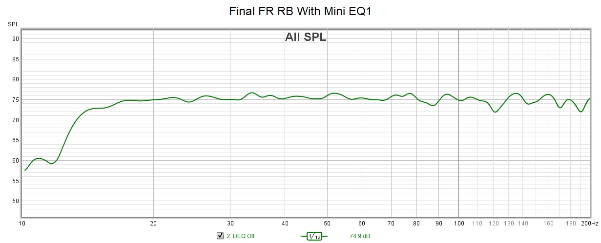

anyways my question is, I have the REW software setup along with the umik mic.. I have all 3 subwoofers i think placed in the best areas for response... I then went into audyssey software and ran that... My problem is the 3700 has 2 independent sub ports but i have 3 subs. I have one line using a Y adapter to connect the 3rd but when running Audyssey i am assuming it wont be accurate.. Since when its playing tones on say SUb 1... its really hearing tones from 2 subs since they are on a Y adapter... When i finished with Audyssey it really brought up the frequencies from 10-60 hertz then like dropped to where i couldnt even hear some of the bass in those ranges.
So in short. what is the best way to calibrate 3 subs using Audyssey with a receiver with 2 Sub outs.
