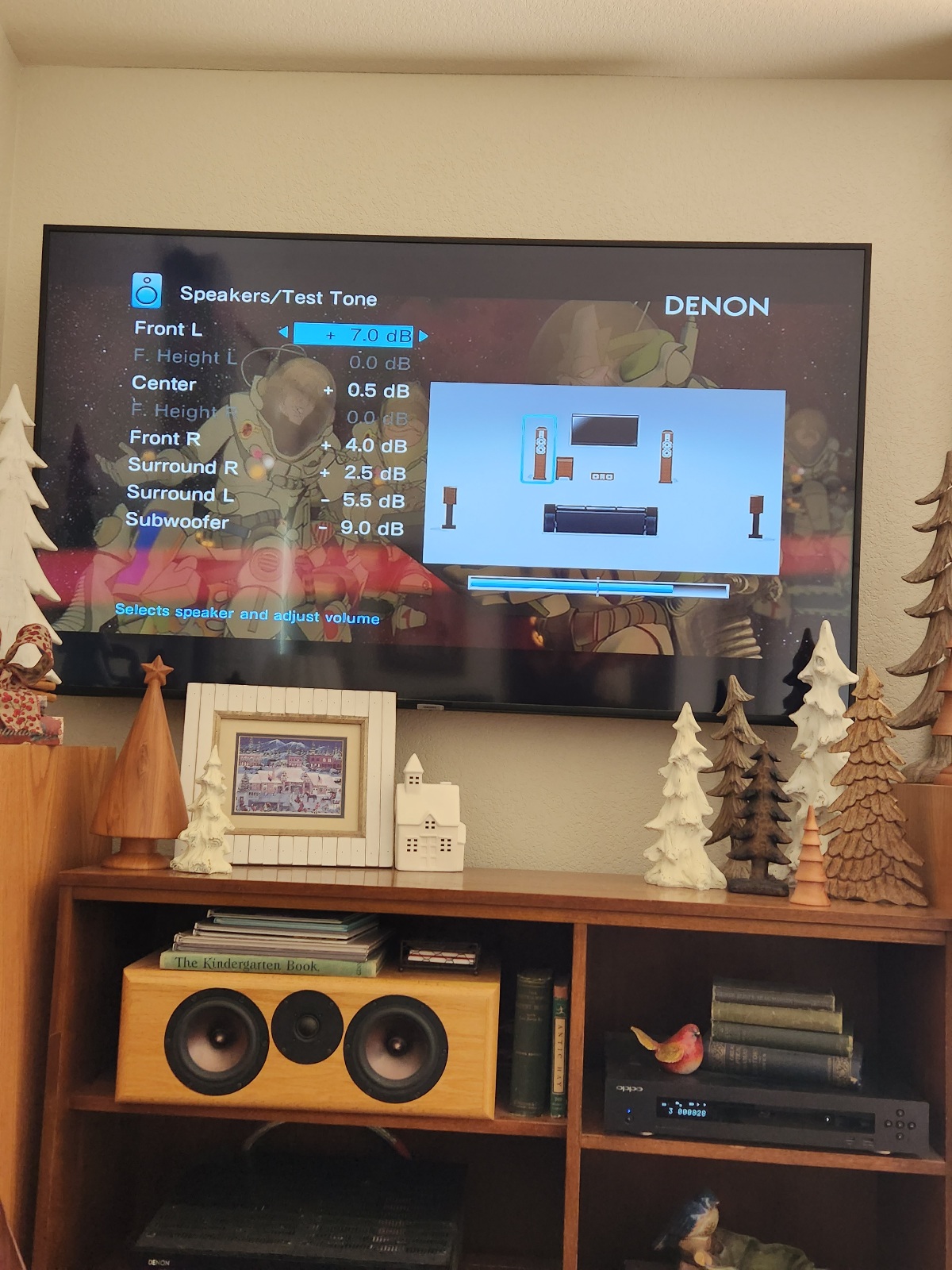

K, thx for your answer. Does that -9 make the sub rumble(?) louder (without turning the actual volume knobs on the avr up?) or lower than say a +9? If I wanted more bass (rumble?), which of the two would I try to set the setting to, -9 or +9? I would think a plus 9, but, I guess I might be misunderstanding the whole thing. I have tried googling this several different times, ways, but don't get an answer that I understand.
I think I downloaded the picture showing my settings after running audessey.
Hopefully your sub is doing more than just rumbling, but per ShadyJ's review here it should be relatively capable. -9 is the initial level setting for flat bass. You can raise the sub trim level, and many do after Audyssey is run, but a swing of 18dB would be excessive. Maybe try 3dB (change to -6) to start. If you had a newer model you could use the Audyssey editor app for more options/control....

I'd move your center speaker up under the TV and re-run Audyssey. It should sound better.

Well, -Jim-, I'm sure your right. If I get the chance, I will see if I can do it tomorrow. It's been like this for quite sometime, not sure how long the speaker wires are from the receiver. (the wiring is a mess in the back, very difficult to get to.) :rolleyes:.

Well, - Jim-, I got it done. I think it does help.
Glad to be of help. My next suggestion would be to spread out your L&R speakers if at all possible, and re-run Audyssey. It should sound even better.

From looking at the photo, I don't think that would be possible. The left speaker appears to be right in the room's corner (as is the left edge of the TV). And even if there was no wall there, moving the right speaker more to the right would then be in front of the window.
If anything, I would see if you could move the TV a bit to the right to at least center it between the main speakers and also move the center to be centered as well. Can't imagine that doing much for the sound, but would look at least visually balanced.

Thx, both of you for your suggestions. BUT (a big but :rolleyes:), the room is pretty much set up in stone as it is. I will include a photo of the actual room in a bit. It is a compromise between equipment and room furniture positioning, etc. I got my big:)cool:) speakers. The wife has the final say so on where everything goes and how it looks in the room. :(.
She wants little hide away type speakers (think Bose). When I put the 5.1 together back then, Bose had a bad rap among "us audiophiles" (which I certainly am not). I wanted nothing to do with them.
Please excuse the mess in the room (new pillows, etc). As you can see, it's not a room made for video or audio entertainment, but it will have to do. No moving the speakers, no moving the tv, sub woofer or anything else. I was surprised she let me move the center speaker to up under the tv.
I'm actually standing in a large opening that leads into the dining room when I snapped the picture.
