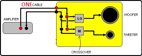

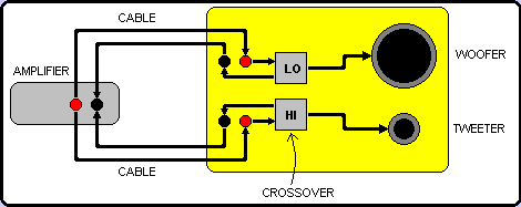

To bi-wire speakers you first, remove the jumper between the top and bottom terminals. and then, run two wires from each speaker output on the amp. One to the top terminals and the other to the bottom terminals.

I'm guessing but he may have new speakers that have bi-wire/amp terminals at the back but he may not be using them bi-wired yet. If this is the case then it's best to just ignore the two sets of terminals and leave the metal straps on them and just wire to one set of speaker posts as this will give you the best and simplest results.
