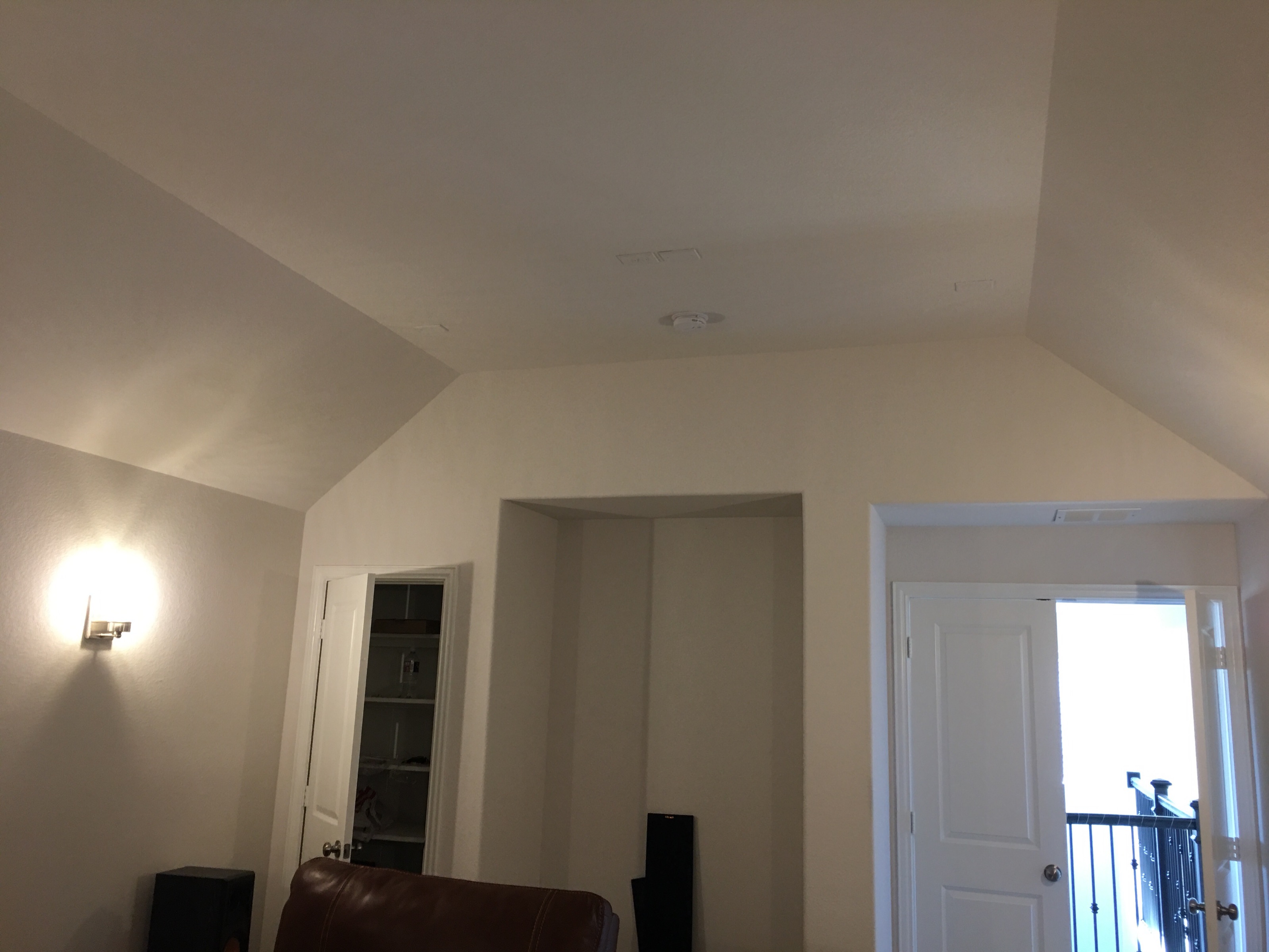

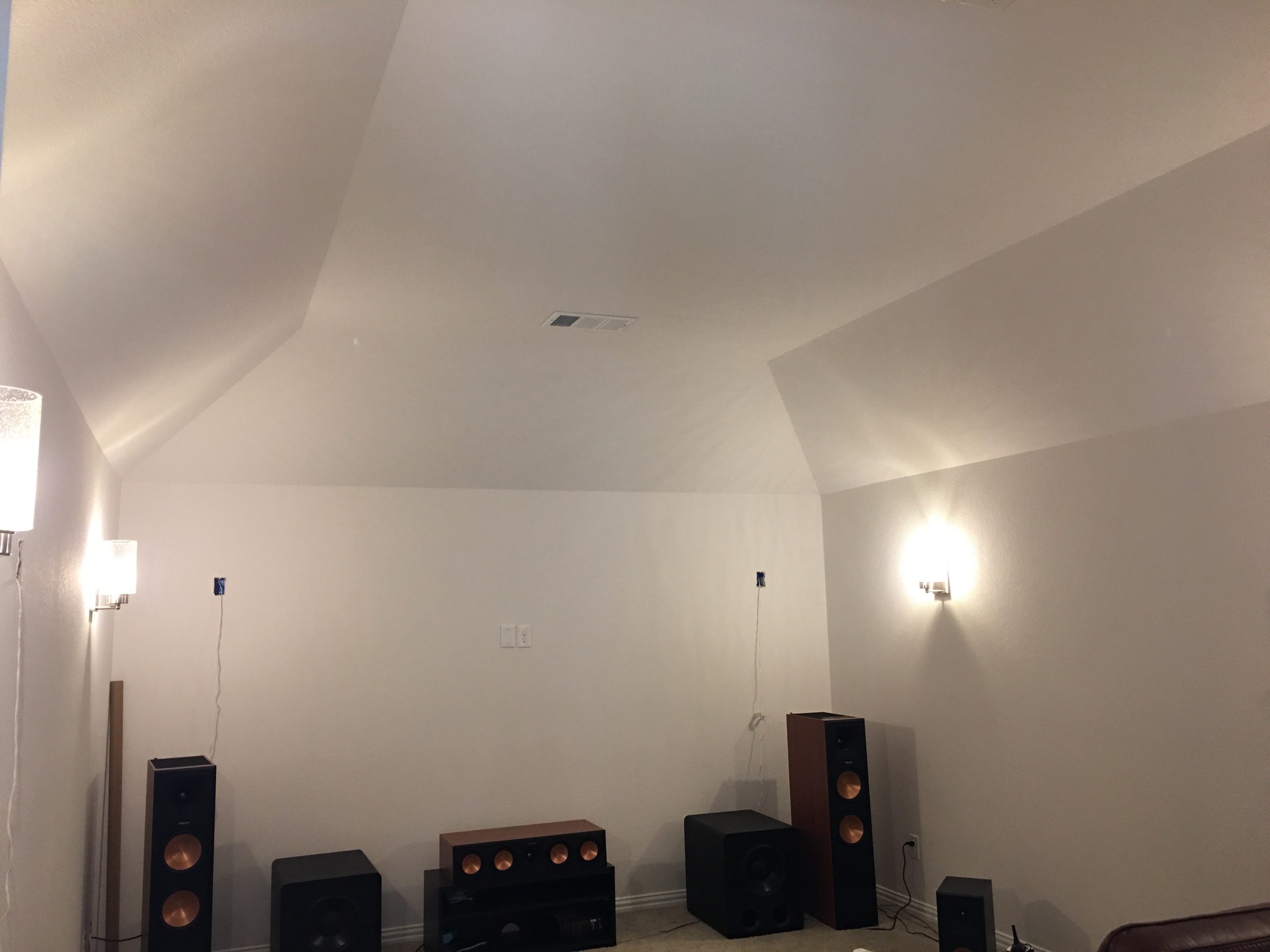

Hello all,
I’m setting up new home theatre.
Room size 18X14(attaching pics of the room)
10 feet height ceiling
Please help me with how many channels can I setup. I will buy new gear based on your suggestions.

It has 11 amps, so you can set up 11 channels plus subs. It has 13 preamp channels, so with a two channel external power amp you could set up 13. However in that room, I would set up a maximum of 11 and may be just 9.

Well, that receiver has 9 power amps. So that would let you do 7.2.2 or 5.2.4. In our room I would do 5.2.4 is you want Atmos. That would give you the front three, two surrounds and four ceiling speakers. If you are not using ceiling speakers I would just fo 5.2 or 7.2. I think if you really want to do Atmos, then ceiling speakers are mandatory. Anything less is a waste of time and money.

Hello @TLS Guy can I do 4 ceiling speakers four surrounds, three fronts that would be 7.2.4 atmos. Do you think will that be good with the room that I have? Sorry for too many questions. Your input will be really helpful to me.

I think the length of your room is marginal for 7.2.4. I think it depends somewhat on your seating plan. If the speakers are too close together it is not good. Sometimes less is more. I would tend to favor 5.2.4 in that room. However if you put in rear backs, you can always turn them off if you don't like it. I have another 11ft in length to work with in my room. I do see a problem with that ceiling for Atmos. The ceiling with the sloping sides in general should be very advantageous as far as irregular reflections are concerned. However it creates a dilemma as far as positioning the ceiling speakers. The ceiling speakers should be inline with the mains, So that would put them on the sloped sides. They are supposed to face downwards. So if it were me I would make some sealed enclosures with angled sides, so they can be placed in the correct position and still face down.
