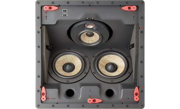

I can tell you I went with downfiring in wall speakers with no tilt and I'm not even that far off axis and I didn't like the results at all. So I'm going with these just waiting for them to arrive
The only speakers I feel should be have to be matched are the front 3 maybe the base 5 or 7 if you really want it. As long as they measure and are tested to perform well in especially with atmos they don't have to be a match with the rest of the system
