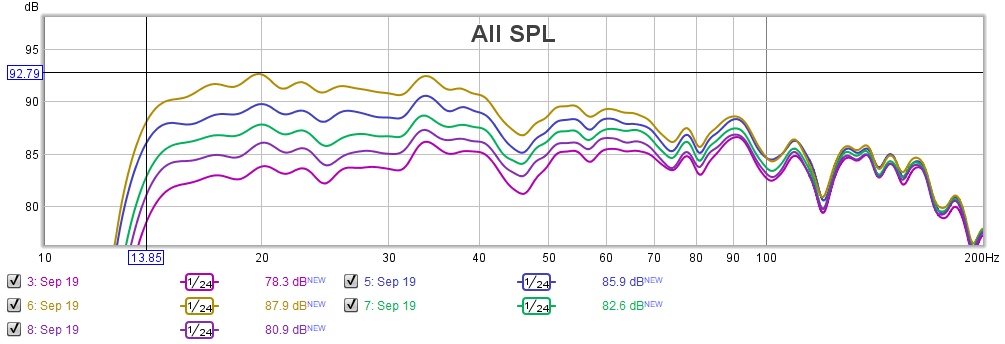

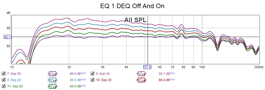

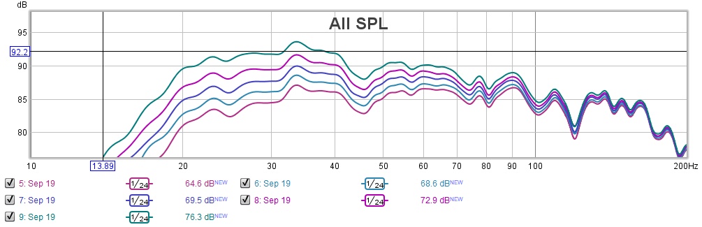

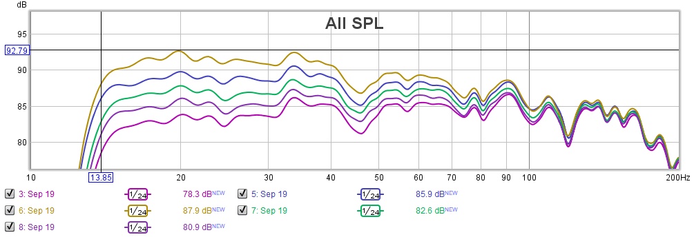

So I decided yesterday to bust everything out and experiment with the Audyssey Editor app and got some pretty good results. I'm going to be doing some more today because yesterday was a lot of refamiliarizing with the REW and MiniDSP software. What I did here was removed all filtering in the Mini and ran Audyssey setup with the app. These charts are my preliminary results with Audyssey with no tweaking at all.

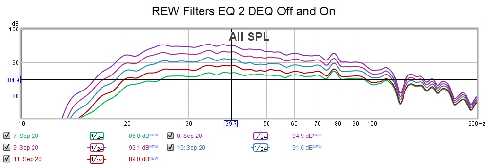

The REW measurements are EQ 1 and EQ 2 with no DEQ, then a sweep with DEQ 0, 5, 10 and 15. I think these are some pretty decent results. Last night I tweaked with the editor a little bit and sent the tweaks to my receiver. I'll be measuring and comparing the differences in a little bit. I'll post more later. Off to a good start so far tho!

You've painted a very clear picture of where your room is influencing the sound, as the peaks and dips are evident in every measurement.
This is where the dimensions of your room, and the placement of every speaker/sub, LFE crossover, and all of your DSP inputs... everything is needed to fully interpret these measurements and prescribe placement/ DSP solutions.
So without ALOT more information, guessing is all that can be done.

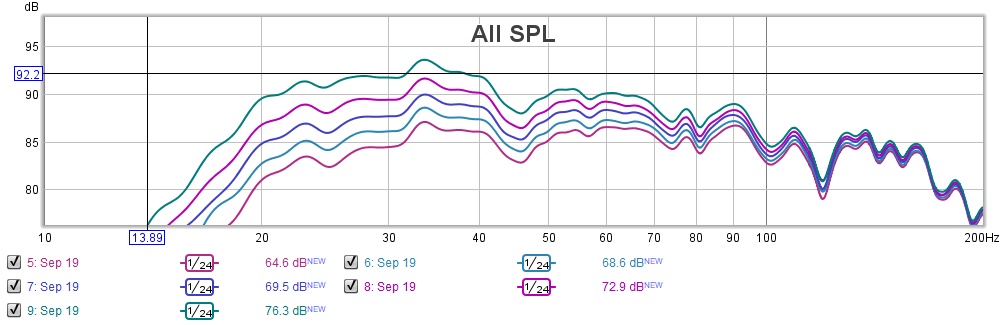

I did a little tweaking using the editor app and did another sweep.
It looks like I'm +/- 3 dB from 100 hz to about 15 hz if I'm reading that correctly? That is with some very minimal tweaking with the app. I'm pretty happy with this result so early into it.

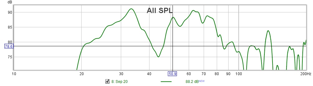

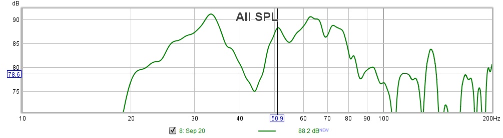

My towers by themselves in Pure Direct. Pretty ugly.
I did move them around yesterday, more than a little bit, and did sweeps after each position change. There were little to no improvements so I put them back where they were. I'm wondering if moving my subs will (and I think it will) change things for the better. Right now they're very close to my towers and they each have one of those 8" drivers firing right into the sides of both subs.
If that does help things then my issue is going to be finding new homes for them. Also... it's more work than I feel like tackling right now... sigh.

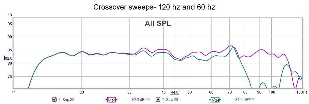

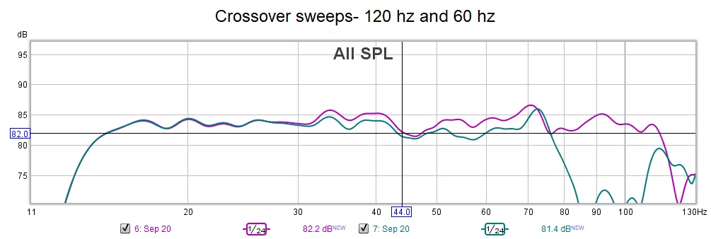

These 2 sweeps are with Audyssey set on FLAT and DEQ is OFF. 60 hz and 120 hz crossovers.
You can pretty easily tell which is which, lol. Again, this is with no Mini, Audyssey room correction only.
It looks like the Audyssey editor app works pretty well with the low frequencies. I'm inclined to believe it can correct frequency response inaccuracies caused by room gain in smaller rooms.
I think I just have to plan to eventually get a Denon or Marantz AVR which has the Audyssey XT32 EQ feature to replace my SR5010.
I think I've just have to plan to eventually get a Denon or Marantz AVR which has the Audyssey XT32 EQ feature to replace my SR5010.
Yes, it's working very well on my subs. Everything below whatever crossover point I choose is pretty solid. Right now I have the Mini in the chain between the bass sections of my towers and amplifier. I'm gonna try generating some filters and see what happens. From the looks of things unless I do some major moving in my room I might just have to be happy with a higher crossover setting. My room and tower speakers just don't want to play well together.
Towers only? Notice that you have a dip in the 40's in the same place as you did with the subs? That's called a room mode. And if both subs are up front by the towers, then that should be all you need to know to confirm the need to move a subwoofer closer to the LP.
Assuming you do still have both subs up front, just pull one sub 3+ feet forward, and measure again at the same place. You should see that mid 40's dip, rise.
Wherever you end up actually moving one sub to, it will influence the room modes in a whole new way. So while the 40's dip can go away, new peaks or dips will come up. And they are ALWAYS related to the dimensions of the parallel boundaries of your room when talking about bass.
By writing out ALL of the parallel boundaries (and yes I remember your room has many) you can chart the resonant frequencies of your space, relative to the listening position, and list the modes out by length, width and height. With that information, you can then start to make a lot more sense out of these measurements!
That is curious!
Have you tried locating your subs where the towers are and measuring PD just to see if you get the same problems with low bass that you see above?
Yup towers only. Subs have always measured better than my towers. I don't have that huge dip with my subs. Only in pure direct, towers playing by themselves.
So, I gave up on trying to tweak my towers so I can set a lower crossover point. It's pointless because I'm certain it's a room mode and the only fix is making some big, major changes and moving stuff around. So I let Audyssey do its thing, then ran a sweep and generated some filters with REW. I didn't go very aggressive with the filter parameters either. It wasn't necessary because Audyssey got it pretty damned close. After that I went in and manually put 2 dB high shelf at 25 hz and down. Check it out. Before and after REW.

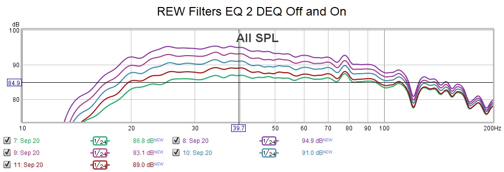

That's weird. When I saved those images the vertical scale was in 5 dB increments. Huh. Well, the actual sweeps still look the same. Except for a little goofiness at 75-80 hz or so I'm pretty flat from 100 hz down to about 15 hz. I think I can live with that! That dip at 75 hz and the peak right after at about 78 hz have been an anomaly every single time I've taken measurements. I'm just gonna leave it. This is one of the best looking charts I've had and I did it with the least amount of filtering. I'm very tickled with these results!
Audyssey modifies frequency at the expense of phase, which you leave out of your measurements for some reason. So it's worth figuring out why the dip in the 40's went away, but the peaks and dips from the 50's and up, remain (despite the before's and after's being in different increments - sure makes things look smooth, don't it? ;-)
