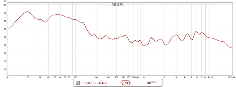

Even my current speakers (EMP Tek R5BIs and center at a 80Hz crossover in my AVR) are elevated in the FR, as I have room curve FR with bass sloping down. Here is full range response with Audyssey on:
I do not notice any problem with male voices etc. Does this FR look troubling?
The display you showed is (one or several?) speaker's in-room response. It includes sound from both the speaker and reflections from the walls. I'm referring to a speaker's inherent sound. This is can be measured if the microphone only hears a brief pulse of sound from one speaker, with a time frame from about 1 to 4 milliseconds. This in effect ignores sound reflected off the walls. I doubt if your AVR can do that, so don't spend a lot of time trying. Maybe I've said way too much here. The bottom line is don't over-interpret your receiver's display. It isn't showing a speakers inherent frequency response.
In the past I heard EMP Tek small monitors, maybe they were R5s, and I thought they were rather good for their price. They certainly did not try to exaggerate bass.
