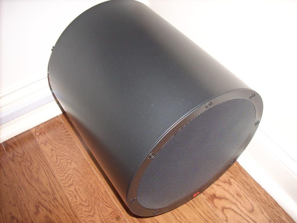

Nice review rnatalli. It sounds like a decent little sub. The Gallo gear I have heard and seen has always been impressive. I may not care for the aesthetic of much of their gear but I can appreciate the build quality and design idea they were going for. Only one thing would have made your review better.......A picture of the sub.;)
R
rnatalli
Ask and you shall receive. Unfortunately, it's the only picture I have. It's my usual spot to test and make sure it actually works before heading to its final destination.
