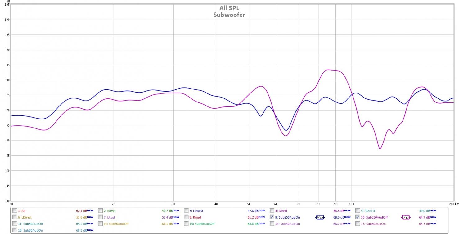

What I want is to have the bass of my mains managed, but not in the subwoofer. I want to run them full range and have Audyssey apply bass corrections. I don't want Audyssey to touch anything 500hz or so and up. This is not possible with Audyssey. "Audyssey" setting is bright and brittle, Audyssey "flat" is even worse with more high end. You think a cutoff frequency would be common sense to incorporate, but alas, no.
