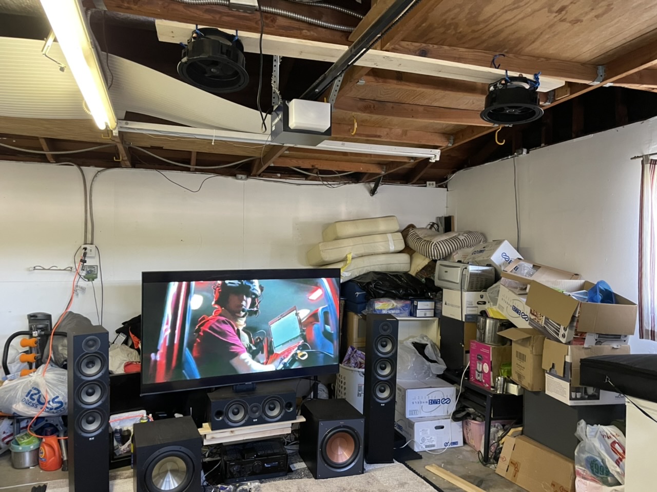

Here’s a pic if you haven’t seen my “ceiling” speakers. I would just do the same thing to the other 2 new speakers but move the location almost on top of chair.

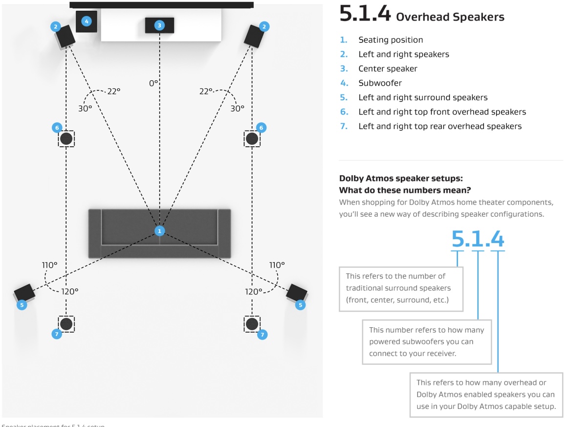

IMO.4 will always be better than .2. In fact, I would advise you to go 5.x.4 and not buy a new AVR. But I f a thousand bucks isn’t a big deal then go for 7.x.4.
FWIW I would advise against the rear tops going almost above the couch. All tops should be 45° fore and aft of the MLP. That means if it’s four feet from your ears (seated) to the ceiling, then your top speakers should be 4’ in front of, and behind your head when seated.

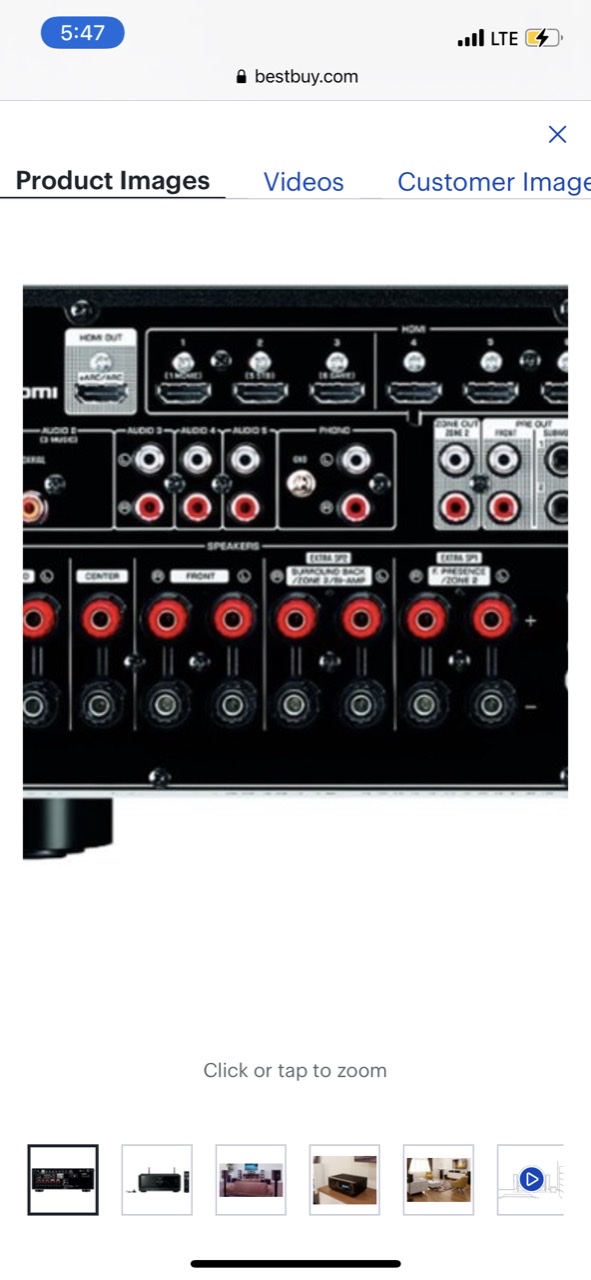

Wait..There is an area in the back that says surround back and it’s not currently used. I always wondered what that was. Here’s a pic:

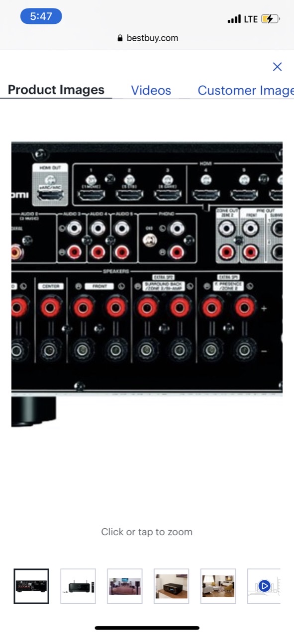

You could likely reassign that to be front height/top. But I still think it’s worth doing .4 if the cost isn’t prohibitive.

Surround back for 7.1, but you are currently doing 5.1.2. So, 7 any way you want ‘em, but just 7.

I thought those might be able to be used as “rear heights “.

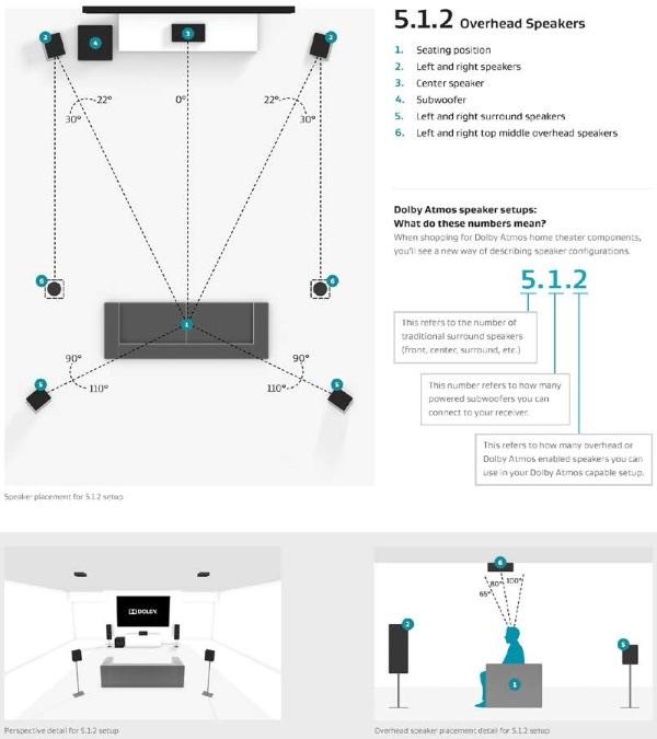

Well if you’re only going to have one pair of tops/heights they will be in front.
This is a stock kind of image with little reference to the angles and distances, and very generic. IMO top fronts would go above your feet if you sat down and stuck them out.
Front heights would go on the front wall where the wall and ceiling meet usually.
I moved my recliner up at bit and repositioned the rear surrounds and now my feet are right under the ceiling speakers. Wow what a difference in overhead experience. Good thing I opted for the big 8” Sonance ceiling speakers.
