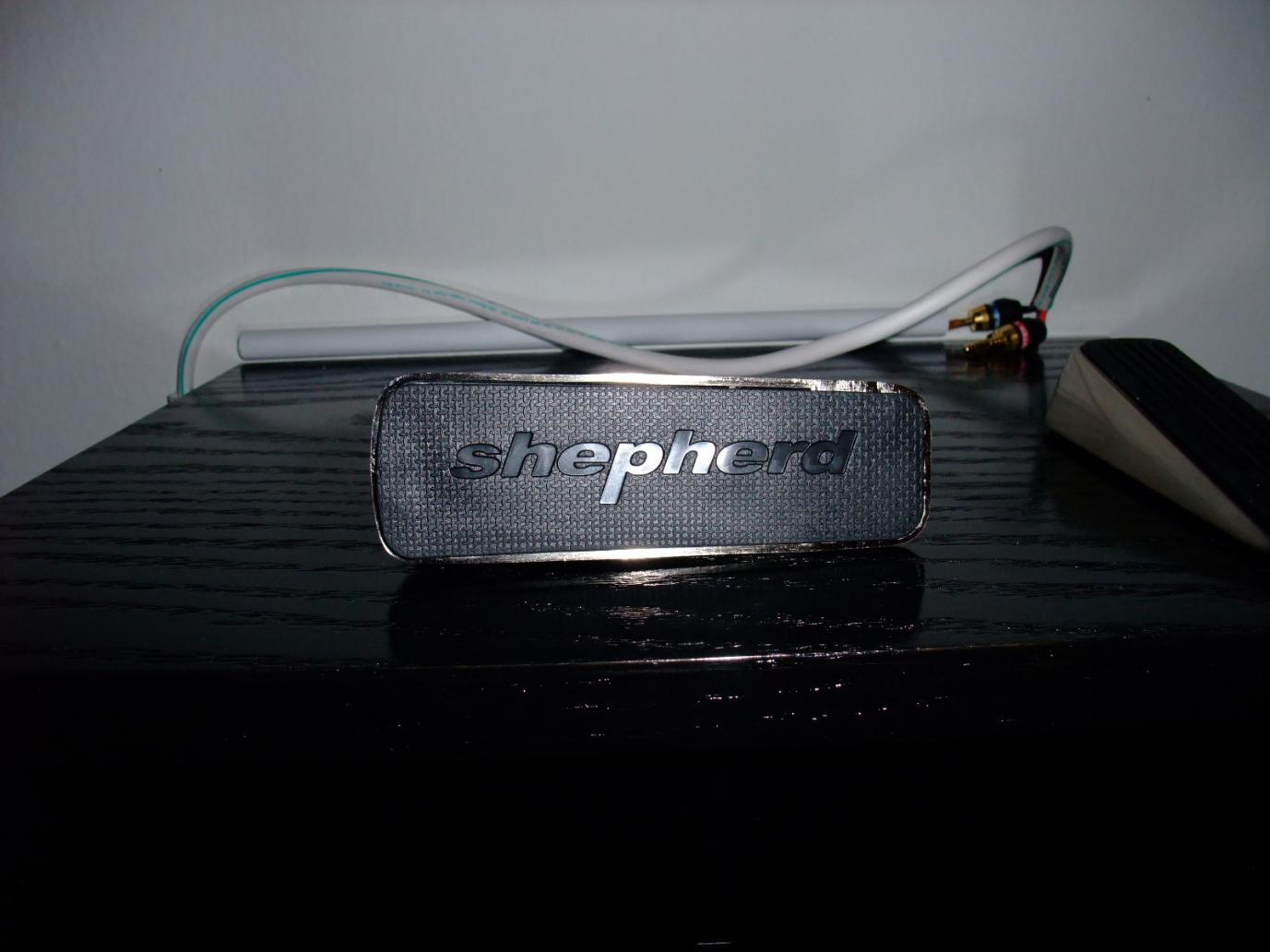

I finely received my Mopads and have a question, does anyone see me having a problem between the front baffle of the speaker and the Mopads upper foam lip that comes up the front of the speaker slightly? I wouldn't want that foam lip interfering with the tweeter and mid bass drivers dispersion patterns, thanks Techlord. :)
The lip should not be a problem. just try to locate the mopads so that they aren't blocking anything.

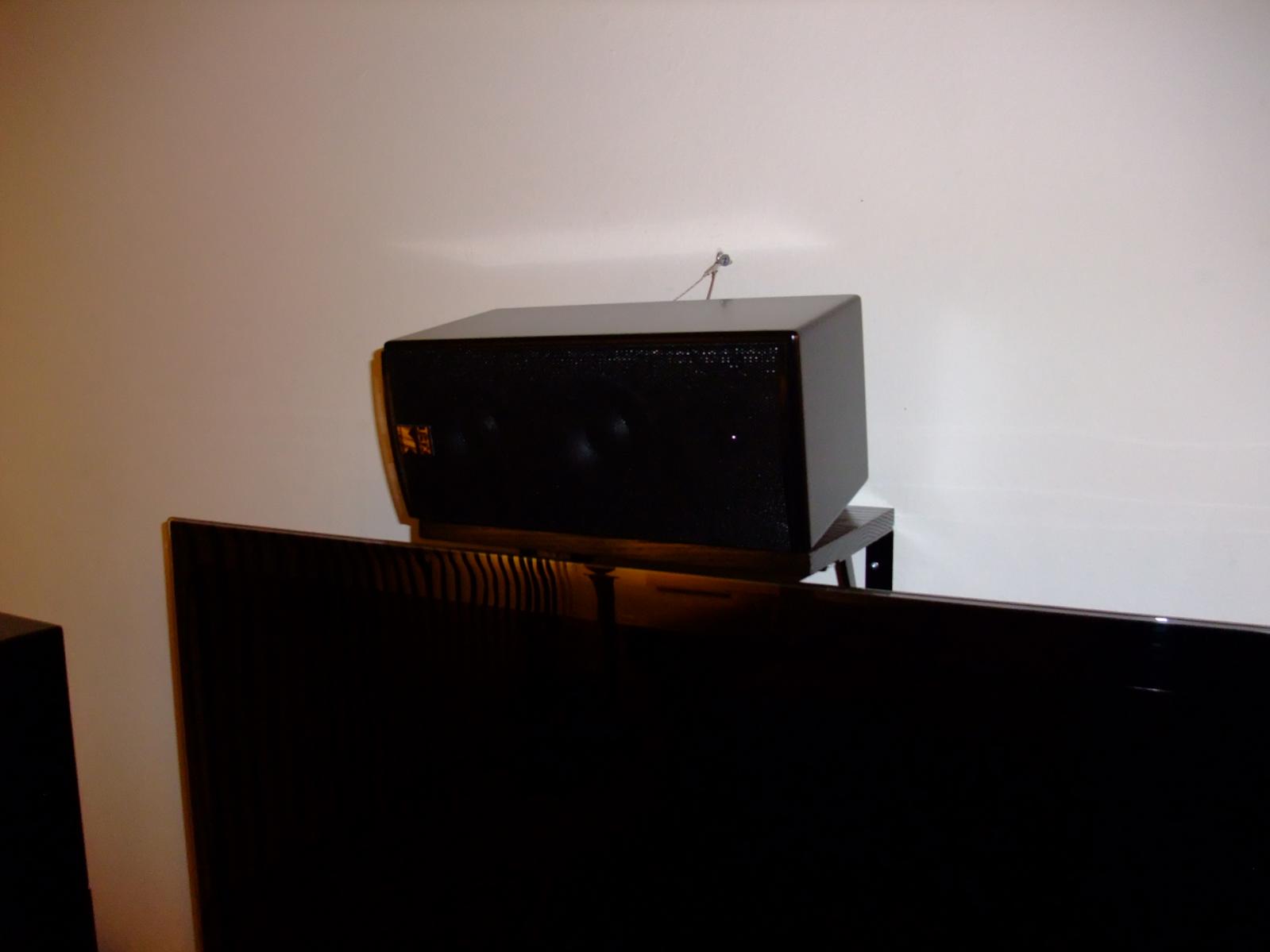

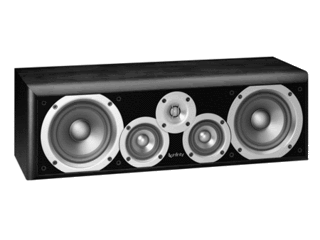

I haven't been following this thread day-to-day but I noticed that you have a speaker on it's side for a center? That can work but if there is some kind of waveguide around the tweeter you may have to rotate the tweeter 90 degrees. You'll just have to look and see if there is something directing the sound (a waveguide) from the tweeter.

By waveguide I'm guessing its the area immediately surrounding the tweeter, here's the picture.

I finely installed the Mopads under my center channel speaker and it sounds more like the L/R speaker now, it not only improved imaging it improved the whole sound coming from the speaker! I started out using three Mopads under my center channel speaker yet ended up using only one of the pads as far away from the tweeter as possible. This gave the best performance, strange one pad instead of two or three gave better results, the imaging I think was getting absorbed by the front lip of the Mopad. Sure I could cut the lip off, but I have my speaker slightly in front of the shelf a bit.
Thanks for everyone's suggestions, Techlord. :)
