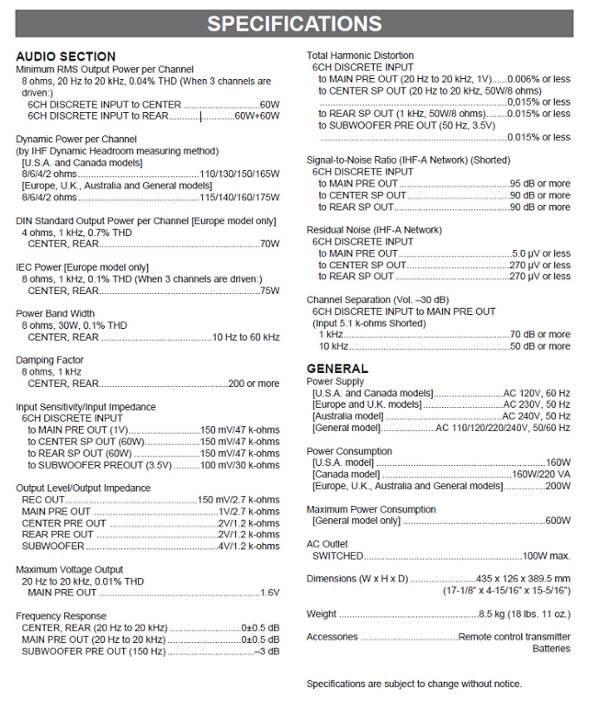

I agree, BUT... I don't think it's bad design necessarily. See specs for this unit on the image attached: I'm using the 6-ch discrete input option, which is detailed separately in the specs.
Can this hissing be localized to that blasted volume pot? As Boerd indicated, he had a faulty volume pot, replacing which fixed the problem (albeit temporarily, probably combined with another problem).
Since I am able to "trick" the problem by boosting the db channel signal electronically within Yamaha while turning down its volume pot, doesn't that kind of point toward the volume pot as being the culprit? I don't know how volume pots work... But maybe I could add a hiss filter across it (some website posted a schematic, involving one resistor and one capacitor)...
