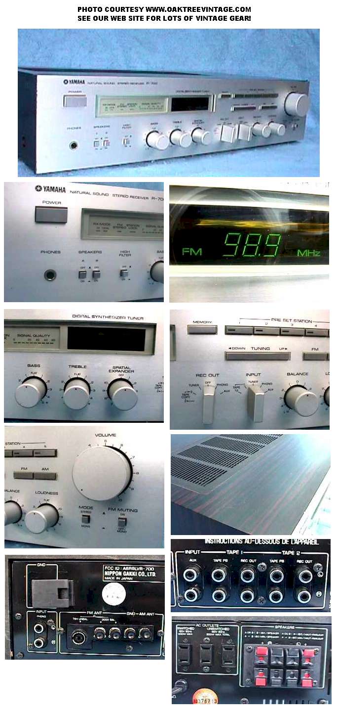

I think he meant to post up Yamaha CR-700, vintage
That certainly looks like it will be difficult to get going...

Sorry everyone I quickly typed that up last night. The receiver is a yamaha R700. Sorry again to anyone that was trying to help me with something that didnt exist.
I downloaded the manual and that device is not compatible with your application. Sorry.

This receiver has pre outs.
There are always a huge number of receivers for sale on eBay. I can't possibly know which models have and have not. I can tell this one does from the rear picture. I'm sure there are lots of others that do as well.
