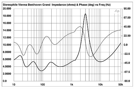

Are your speakers the VA Beethoven Concert Grands, as in this Stereophile review?
The reviewer noted that these speakers were less sensitive, 87 dB, than the manfacturer claims at 91 dB. Be aware of that.
The best way to estimate how difficult speakers are to drive is to look at the speaker's impedance vs. frequency curve, the solid black curve in figure 1 of the review.
The manufacturer claims 4 ohms impedance overall, but around 100 Hz, the impedance drops well below 4, to under 3 ohms. The reviewer says, "this will stress tube amplifiers, given how much musical energy can be present at that frequency". I think that is a gentle way of saying, these speakers need plenty of power. Also be aware that the amplifier used by the reviewer is a brute, 1000 wpc at 8 ohms, 1800 wpc at 4 ohms, and stable below 4 ohms.
I'm not saying you need an amp like the reviewer had, but perhaps the MacIntosh you mentioned might not be enough for these speakers. If I had that choice, I'd go with one of those ATI amps.

Are your speakers the VA Beethoven Concert Grands?
Yes, they are the concert grands. And, I did read that article a while ago, but must admit that - being new to this stuff - I didn't quite know how to interpret the numbers/graph. Your post is very helpful. I think that I'll go with ATI or something like it with plenty of wattage, and wait for a higher-powered McIntosh (MC2500 perhaps) to come along at the right price somewhere....
