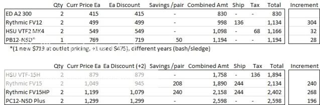

If you get duals of any of these you have to remember that you wont be pushing them near their max output, specially in your size place. So for instance if you went with the Rythmiks i think youd be wasting your money by going with the FV15HPs. Instead youd be better off with dual FV15s because you wont even be pushing them very hard to get past reference.
Please explain the math on this one
Reference is 115db? Headroom is another 10db? Listening position means approx -18db??
depending on the amount of room gain he will be pushing them to their max to hit reference with enough headroom

I mentioned earlier, having dual subs with them in different locations isn't really about getting a lot of extra output. It's mostly about getting more even frequency response thought the room. You do get SOME extra output, but not nearly as much as you might think.
It's important to have the headroom right from the start if you want that tactile impact. So that's why I'm recommending the VTF-15H or the Rythmik FV15HP or SVSound PB/PC12-Plus if you can afford one of those two. Adding a second of any of those subs will smooth out your frequency response at more positions in the room, but it'll only add about 3dB more headroom. That's significant, but not so much that I would recommend getting lower output subs just because the plan is to get a pair. As I said, a pair of PB/PC12-NSD would be right on the cusp. I could certainly recommend it, but I'd personally feel more comfortable with more headroom available for those peak transients.

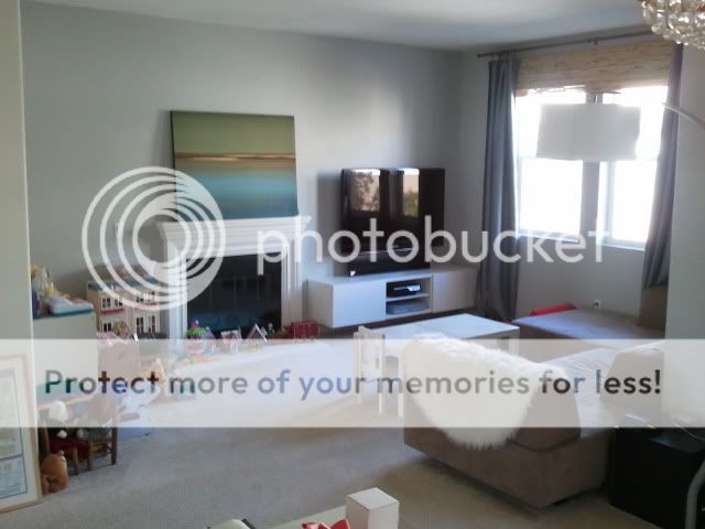

2. His rooms look small enough that the models i recommended would be plenty IMo.

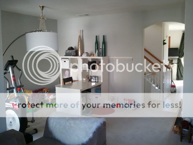

Like I mentioned before, due to that hallway, the open space is actually larger than what we're looking at in the photos or the diagram. That pressure escapes where ever it can! If the hallway wasn't there, I'd likely agree that the higher output subs aren't really necessary. But with the pressure escaping down that hall, I just think the higher output is in order :)
