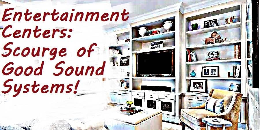

Putting acoustic treatments in an entertainment center is not going to help the sound. Entertainment centers are mostly a disaster for sound quality. Here is a recent article on how they destroy good audio.

You need to talk to your wife. Bookshelf speakers are not resigned to put on bookshelves! If you want to do what your wife wants, then you will have to design and build speakers custom to that location, if you want good results.

If possible get tower speakers or bookshelve stands. Telll her to read that article on link above ... once you get used to towers or proper placement it would sound good enough you won’t notice them .

I would keep using stands myself, but that's because I like good sound. As far as entertainment centers and speaker placement in general goes...
