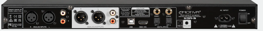

I'm hoping for a path check, and for advice in a good way to send a quality stereo signal to a new, soon coming Emotiva XDA-3-PreAmp-DAC that will be feeding XPA-DR1 Monoblock's XLR-balanced. Ordered, but not yet delivered. The Emotiva 25% off event helped me to decide to go big. I understand electrical and electronics pretty well, but some of the new technology I need help with.
XDA-3 Differential Reference™ DAC : Digital to Analog Converter : Emotiva – Emotiva Audio Corporation
XPA-DR1 Differential Reference™ Monoblock Power Amplifier : X Series – Emotiva Audio Corporation

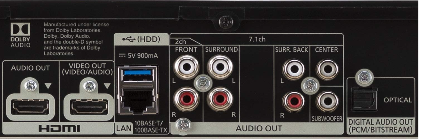

This seems like a decent option $450
Panasonic Streaming 4K Blu Ray Player with Dolby Vision and HDR10+ Ultra HD Premium Video Playback, Hi-Res Audio
Amazon.com: Panasonic Streaming 4K Blu Ray Player with Dolby Vision and HDR10+ Ultra HD Premium Video Playback, Hi-Res Audio, Voice Assist - DP-UB820-K (Black) : Electronics

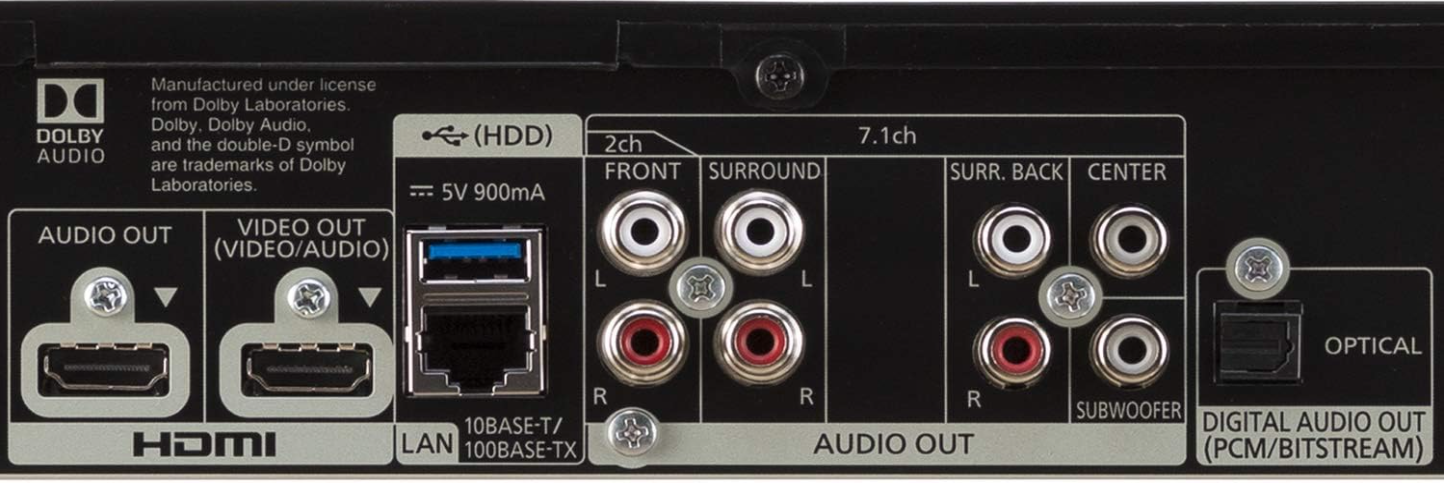

My old Marantz SR7002 is noted below.
I understand a new AVR of some type would work, but I don't know if I need to spend very much money on an AVR with a lot of features that I won't be using.
Ideas? Advice?
Marantz SR7002 Receiver Review | Audioholics

The HDMI ARC port on the XDA-3 is meant for connection to a TV supporting ARC and has limited bandwidth. The XDA-3 does not support eARC and its expanded bandwidth. It also cannot accept and decode Dolby or DTS signals.

Unless I misunderstood what you meant, I would say there is no good reason to send a digital signal to the XDA-3 DAC if you want to have the highest audio quality, but if you really want to do it for some reasons, you can use the optical output that the old SR7002 does have.

For best audio quality (theoretically), you should use the asynchronous usb input of the XDA-3 and feed it from a desktop, laptop or notebook PC.
The Firestick will work, but you would want to connect it via a splitter so it will be connected to your TV as well.

If you are an Emotiva enthusiast, the BasX MC1 can be connected to the Marantz. The BasX MC1 has 13.2 analog outputs and the Marantz 7.1 CH IN analog inputs. So, you could configure the speakers for 7.1 or 5.1.2 in the BasX MC1 connected to the SR7002 if wanting to enjoy Dolby Atmos and DTS:X.
The HDMI ports on the BasX MC1 will give you the most audio options. The USB port on the BasX MC1 is limited to 16/48 so no same in, same out for hi-res if you care about it. Optical supports 24/192. Many don’t these days. Dolby and DTS are also supported over optical unlike the XDA-3.
The BasX MC1 and Marantz SR7002 amps will deliver quality audio and the money that would have been spent on Emotiva amps can be spent on a new 4K TV for quality video. The BasX MC1 has six HDMI input ports for directly connected 4K @60Hz devices and has an eARC port for full bandwidth of audio signals coming from new 4K TVs supporting eARC.
