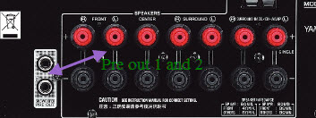

If I have:
1. two unpowered in ceiling subwoofers
2. rx-v675 receivers with two pre-outs connection
3. an amp from Dayton APA 150 with a L and R inputs
I want to be able to power the in ceiling subwoofers a little without having the ceiling shake too much. I don't really care much for the heavy base, just a little.
Scenario A: How or what is the best way to connect these? Do I just use one preout on the receiver and connect it to the L in put on the amp and set the amp to mono. Then connect the two in ceiling subwoofers to the output with the speaker cables?
Scenario B: Or do I use both preouts and connect them to the L and R on the AMP and set it to Stereo or Mono.
Scenario C: The other option also I was thinking is maybe drive the in ceiling subwoofers by also connecting it to the Front speakers to the amp and use the low pass freq to filter out the highs? Can I connect them that way? with front speakers and another set to the amp to drive the woofers? would that damage the receiver or any other settings for this (LARGE or SMALL)? In this scenario, I am thinking I can drive the two ceiling speakers with the low freq but not too much and then also use the second preout connection for a powered subwoofers on the floor?
Can someone offer advice on the best setup?
My goal only is get some mild base with the ceiling woofer but not so much where the ceiling would shake.
I am new at this so any detail advice or explanation is helpful, especially with connections and settings?

I'm pretty sure that receiver has subwoofer outputs which use the receiver's internal bass management. Thst's what you would want to use instead of preamp outputs.
Connect the subwoofer outputs (or use a "Y" splitter if you only have one) to both channels of the 150 and send the individual outputs to each subwoofer.
simple, safe, and efficient.

Scenario A: Do I just use one preout on the receiver and connect it to the L in put on the amp and set the amp to mono. Then connect the two in ceiling subwoofers to the output with the speaker cables?
No
Scenario B: Do I use both preouts and connect them to the L and R on the AMP and set it to Stereo or Mono.
You can do this, but set the AMP to Stereo to use the capability of these speakers
?? Do you have some other speakers you did not list above?
- The option you describe here is not clear at face value.
?? Where are the in-ceiling speakers located in the room and in reference to any other speakers and/or a Home Theater display?
- You also have the option to connect the in-ceiling speakers directly to the speaker outputs on the rx-v675.
