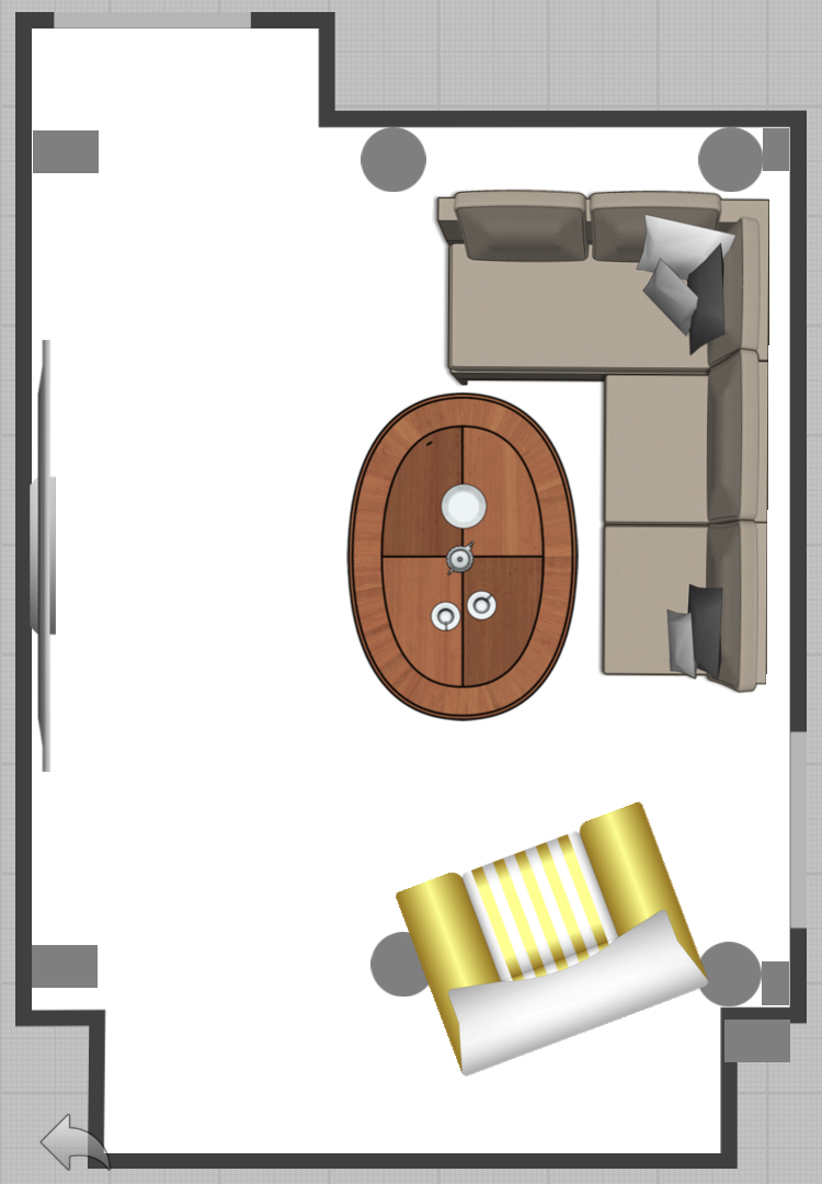

I’m renovating my living room which means I can decide where to put speakers and wires (including chasing the in the brick walls); I’ll be installing in ceiling speakers so I can have Atmos, but unfortunately the sofa will have to be against the wall (it makes more sense generally, but I don’t exclude that I’ll bring it a bit away from the wall
The two big rectangles are the left and right main speakers, the smaller rectangles are the surround speakers and the circles are the atmos in ceiling speakers
Ignore the rectangle at the bottom right (I couldn’t manage to remove it from my crappy design app)
The listening point would be the two left seats on the sofa, so the surround speakers will be more or less equidistant (provided the door is closed)
What do you think?
DigitalDawn
DigitalDawn
I think your seating is way too close to the back wall and 4 speaker Atmos isn't going to work well.
My recommendation is to move the couch at least a foot forward and use two bipole speakers in the back wall. If you want Atmos, I would just go with 2 Atmos speakers in the ceiling in front of the listening position.

How deep is the room?
I agree with dawn, if you can’t move the seating off the wall then there’s not too much point in x.x4. Also, In looking at the photo, I’d say the height speakers should come into the center a little bit. Some guides show to align them with the mains, but speaker principles are still pretty much the same as always and it looks like they’d be too far apart to image properly with the bed layer. You’ll also want top speakers with wide dispersion.

The room is 3.5 m deep (from back wall to tv wall); wouldn’t 4 atmos speakers still be better than 2 for panning effects?
Obviously I can move the rear atmos speakers even further back, just over the surround speakers (but maybe closer together)

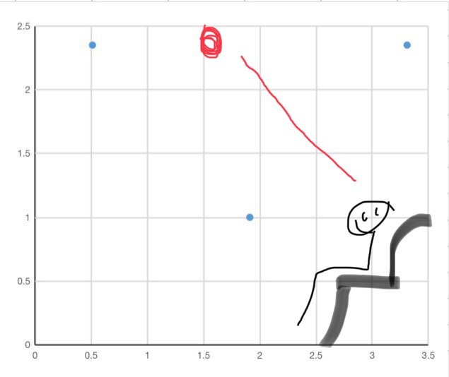

Well, if I look at the side view at page 29, if I were to have the front atmos at 45° and the rear ones at 135°, assuming a sitting height of 1 m and a ceiling height of 2.35, my front atmos speakers would end up almost above my LCR
In this scheme, the back wall is on the right and the screen in on the left

In your first image your couch is up against the wall so at 45° the front TOP speakers would be about 1.5m(5’) from the front wall.

Also, the images that Dolby uses are just for reference to illustrate the layout. A little generic for my liking.
William Lemmerhirt
William Lemmerhirt
They do recommend like 64-100° for 5.1.2 which makes more sense in your room. Having more speakers, but in the wrong places will not help imo. Again, I would do 5.1.2. In your situation...
