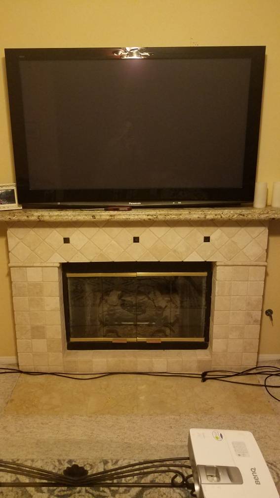

Totally agree with your assessment and advice. Except (there is always an except haha) the TV above fireplace will NOT get hot if the fireplace is gas fired fireplace. I have been using this
set up for the last 15 years and my TV never got hot. See pic. Below.
Yes, agree that the TV is too high for comfortable viewing but that is a personal preference. In fact high TV is better if you want to lie down with your significant other to watch a movie at night.
