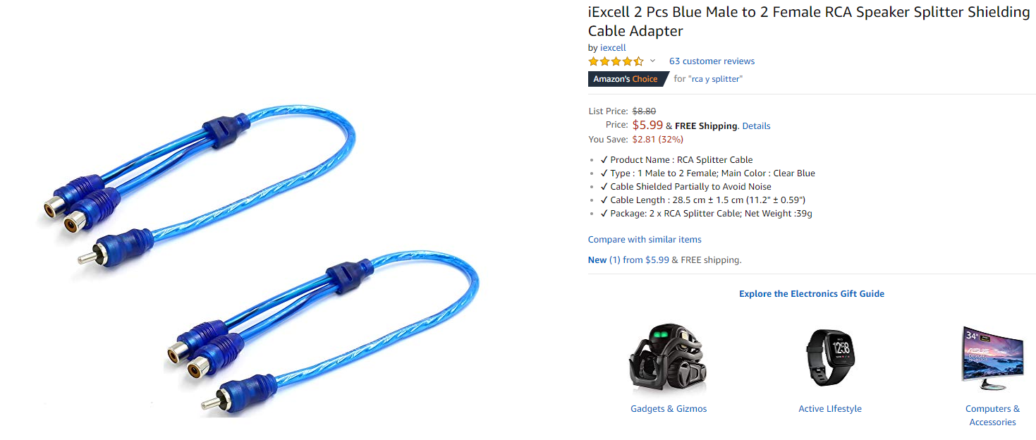

If all of your outputs are taken, would something like this work for you?

Use the Y RCA adapters they will work fine..
Just my $0.02... ;)
harryglevine
Thank you too. Clearly that's the easiest thing to try first. -Harry
