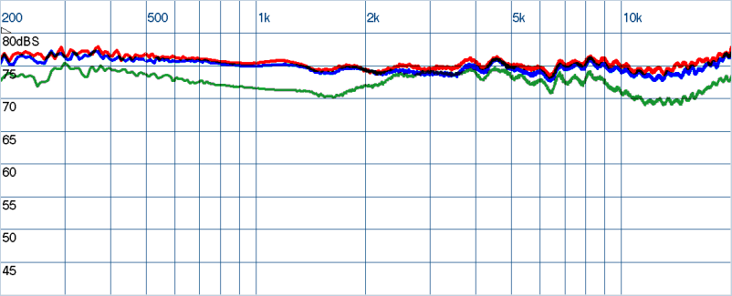

This looks pretty good all around. Measurements taking at on axis, 30, and then 80 deg.
