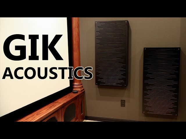

Looking at this video they look like a pure wood panel over the panels - this looks more reflective than my actual wall itself!

I liked this design:
Do I need to worry about this reflecting too much because the slat size is so small?
