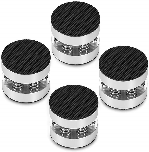

Nostromo
I have ordered these from Amazon to place under my subwoofer. I'll place a Auralex Subdude HT acoustic pad on the floor, place these feet on top of it and then the sub on the feet. Will that help?
PS: This is for the master bedroom where there is no granite shelf or cavity like in the lounge that I mentioned in the previous post)
Nobsound 4PCS Silver Aluminum Spring Speakers Spikes Isolation Stand for HiFi Amplifiers

You've already got the answers as quoted above.
Whatever you put under the sub might help with alleviating some of the vibrations going through the sub and into the floor, but the sound waves are still going to travel from your sub, through the air, and then through the walls and floors. Sub bass is notoriously hard to contain. You would really have to rip down and rebuild the room with proper sound mitigation technologies built into the walls and floors to prevent AS MUCH bass from travelling through. All these things you want to try are putting band aids on cannon wounds
