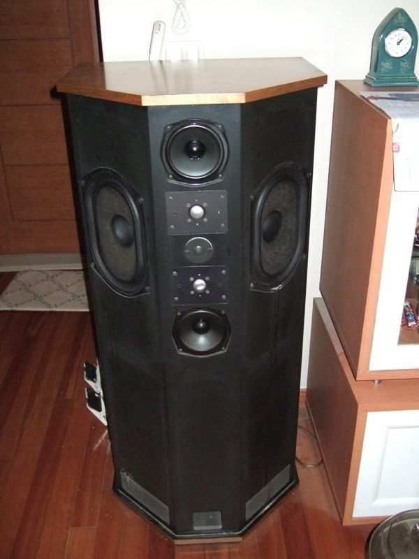

I have been looking for a picture of John Wright's (TDL) last design just before his untimely early death. It is his dual TL speaker.
It is a dual TL. The two bass speakers are actually in one line and the two smaller drivers in the other.
It looks as if someone may still own one of these speakers.
As far as I am aware, the BBC Maida Vale monitors, this TDL speaker and my left and right mains are the only dual TDLs built. The BBC speakers are long dismantled.
Interesting looking design. An early WMTMW. Looks like it should have a very broad horizontal dispersion. Potentially very narrow vertical dispersion. I would be curious to know the crossover design and driver performance.
TDL made really good drivers, and John Wright's crossovers were second to none. That was a really expensive speaker and few were made.
That design was a major part of the inspiration for my left and right mains.
Now that those bass drivers are in production again, it would be nice if someone posted design schematics. Would have to be a real enthusiast as most collectors would be leery about dismantling a rare vintage speaker. I assume the crossovers would have to be redesigned as the mids and tweeters would be long out of production.
That is an interesting speaker. I could hardly believed it when that picture popped right up on my feed. The carpentry of that speaker is very complex, so it was easily the most expensive speaker in the world when released. John Wright was the principal designer of the lines for the BBC monitor. Others involved where Peter Walker of Quad who provided the amps that were modified 405 II boards, and he designed the active crossovers. Jim Rogers was also involved as was Raymond Cooke of KEF. As told to me by John Wright, the key to dual lines is to have the F3 of the lines half an octave apart. John Wright died suddenly in 1999 of a heart attack. TDL was sold, as usually happens in the UK to pay death duties. So few of those speakers were made, I do not know how many.
Now those lines were designed before HT and did not allow for the incorporation of the subwoofer feed. In any event those TDL speakers were passive. The other issue is that they were designed before George Augspurger published his landmark paper on TL design in the AES journal in 2000. The landmark piece of that research is that the volume as well as the length of the pipe is crucial. I suspect that John Wright got is close by trial and error. I have never heard those speakers.

Very fortunate indeed. I wrongly assumed that the TDL would have used George's work. It's interesting that they managed that design without it. While the TDL is large by today's standards, it pales in comparison to your mains. When speakers get that large you really need a dedicated space designed with audio in mind (proper room dimensions). That TDL looks small enough that it would still fit in a retail setting.
I don't know what it's f3 was but I doubt it was in sub range quite. I would take a guess that f3 was probably around 30Hz, as those bass drivers were closely modelled on the KEF B 139s.
