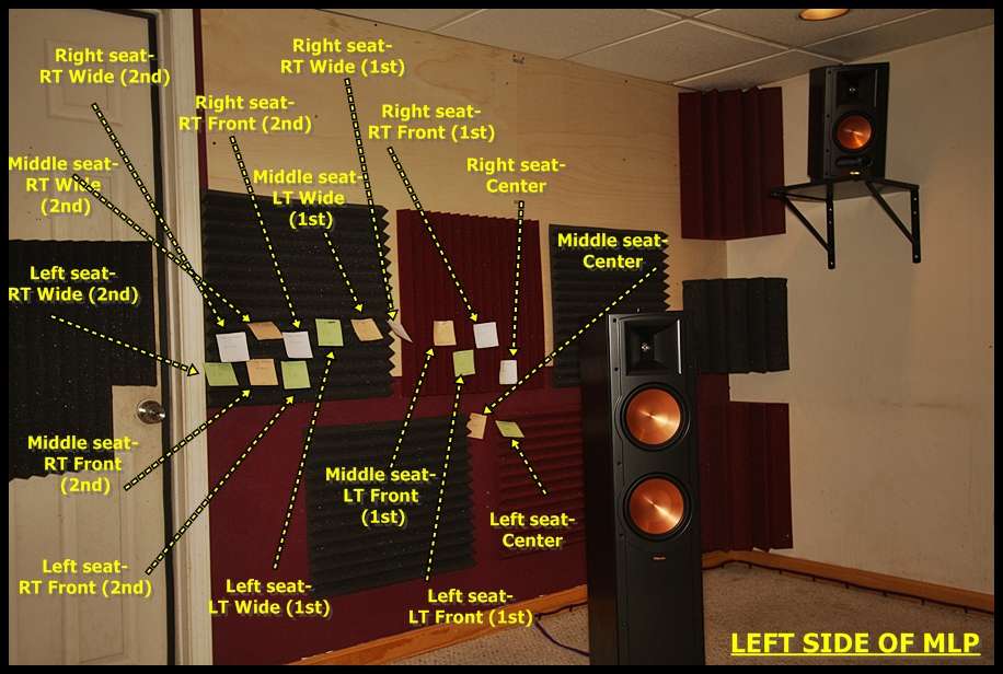

I actually had these made by GIK...but they do have do it yourself material...I think it is the same as the burgundy material but just in white. Here is a link to the material they have...also they will help with your room (talk to Bpape). I have 8" traps spaced 6" apart on the back wall, 6 panels at 1st/2nd reflection points on the ceiling, 3 panels on each side of MLP for 1st/2nd reflection points, 1 panel behind my fronts (plan on making the entire front walll dead to minimize surround reflections going to MLP from front). I have 2 QRD diffusors on back walll and will be putting 2 more QRD diffusors at rear of sidewalll to bring up the surround field. If I where you I would make sure to trap the corners...that will really help the bass....actuallly amazing the difference the tri-traps made.
To find reflection points:
For ceiling reflections basically measure from each seat to the the speaker, take 1/2 the distance and that is your reflection point. For sidewalls you need 2 people....sit in MLP and have someone run a mirror across the side wall and when you see the speaker that is the reflection point...1st reflection point will be the speaker closest to the wall, 2nd reflection will be the speaker usually on the other side of the room.

Yep, basically say you have 5.1 system and are sitting in MLP the right speakers 1st reflection point would be the right side wall, the 2nd reflection would be from the left speaker. Usually they are actually pretty close together....if you have a 9.1 system it can be quite confusing here is mine when I was using foam (terrrible stuff) LOL!! Keep in mind if you only want one good seat do this from the middle seat of MLP...I suggest doing this to all seats. So you would get your reflection points from middle seat, then go to the next seat and so on..
