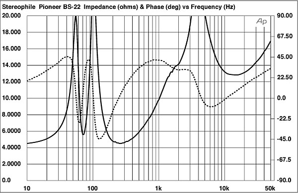

Those speakers should be OK with that receiver. If you play music loud for long periods, and the electrical load is too much for that receiver, it will shut itself down. The impedance load of those speakers is not the friendliest for cheap amplifiers though:
its surprising that entry level speakers would have nearly four ohm dip in mid to upper bass. But as long as you don't blast high volume content for long periods, you should be OK. If the receiver keeps shutting down in the middle of playback of some kind of content, time to look at another pair of speakers or a more robust amplifier.
