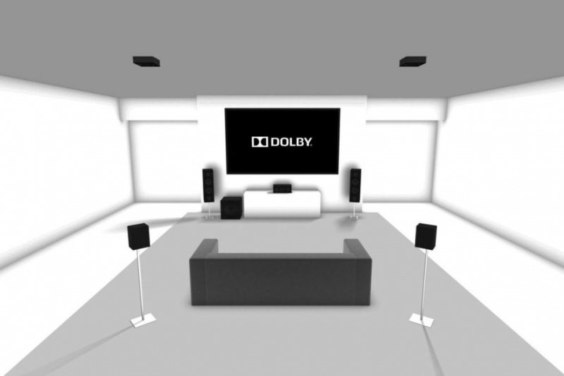

First thought that comes to mind is whether you'd be inclined to set up for a 5.1.2 Atmos configuration vs 7.1 given that your prospective Onkyo supports it. In that case, you'd want a set of side surrounds around ear level, a pair of in ceiling speakers configured like so:
http://www.audioholics.com/audio-technologies/dolby-atmos-home-theater-101/5.1.2.jpg/image_view_fullscreen

Yeah, I thought about it, but I doubt I can convince the wife to let me put the side surrounds at ear level - whether in the wall or on stands.
