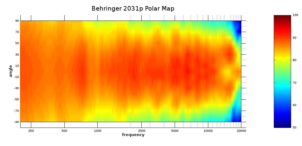

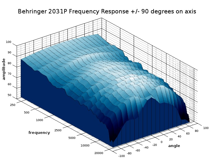

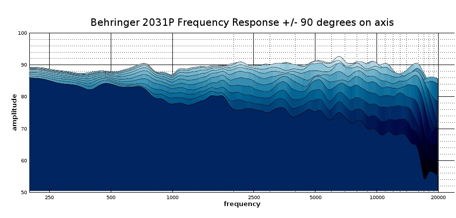

I have measured the 2031P Truth Monitors, the directivity is well matched. Here are some graphs:

That's one, I forgot it was a 8.75-in woofer!
So it looks like maybe the word that the 2030's we're better through the xo range was/is unfounded?
The 2030p might have better directivity control, I don't know about that one, all I can say is that the 2031p is not bad at all. If you squint you can see a slight narrowing around the crossover point at 2 kHz, but I doubt that would be audible at all. It could be that the polypropylene cone helps to alleviate beaming and breakup modes.
Back in the day, you could sometimes get these for as low as 120$ each, which made them an absolute bargain.
