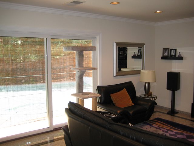

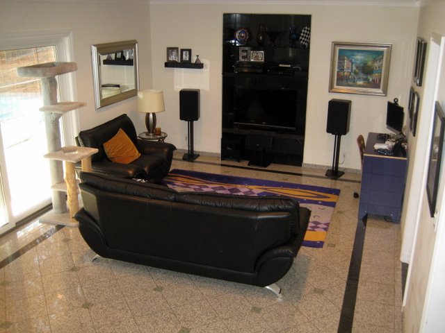

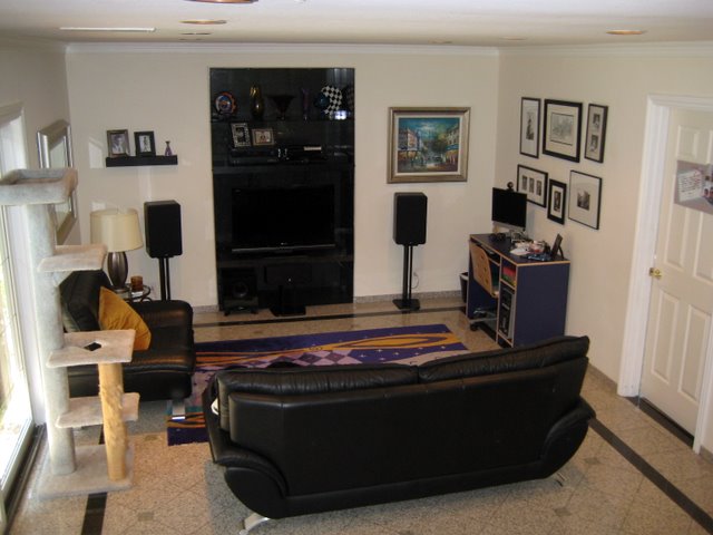

I'm currently running a 3.1 setup and want to move to 5.1, and while I know I need to upgrade my fronts and sub, my next purchase is going to be surrounds. I'm hopeful someone can provide advice as to the type of surrounds, the location of the surrounds, and specific speaker recommendations (budget up to $400, though I'd prefer to spend less.)
My room dimensions are 20 x 13 x 8 (though there is no rear wall as it opens to the kitchen.) Because of the configuration of the room, I've always assumed bi-polar side wall-mounted surrounds (high on the side walls just behind the sofa) are best for my situation, but I'm really not sure.
I've attached a few photos of the room.

Generally, and in your situation, multi-polar side-surrounds are positioned directly to the side of the listening position where your patio door is located. It is also best if there is a rear wall to bounce the sound off of close by. It looks like you need to position the speakers to the left of the patio door positioning it a few feet behind your listening position. Bookshelfs, on opposing walls facing each other a few feet behind, work very well for surrounds in a 5.1 setup.

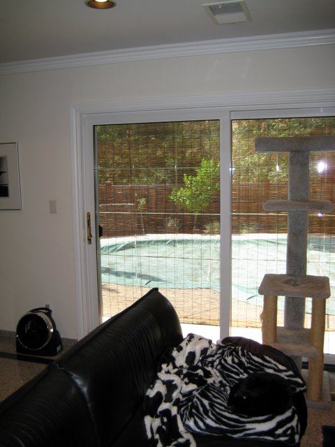

As far as attaching the surrounds on the side walls, the only portions of the side walls that are directly across form each other is at the 7' level (just above the patio door.) That locations provides about 11" of height (between the crown molding and patio door trim). While I know this is not an ideal location, I don't see an alternate location if these surround speakers are to be wall mounted.
I guess I could consider ceiling mounted, but I understand that location is far from ideal for surrounds.
If I do go with wall mount (at the 7' level) I guess I could get some type of bracket that would allow me to point them at the appropriate location.

If you're talking in-ceilings, I have no problem with them. Sometimes they may be the best option. I actually use them for my rears as my situation is similar to yours. Manufactures off some good options in your budget if you're interested.
