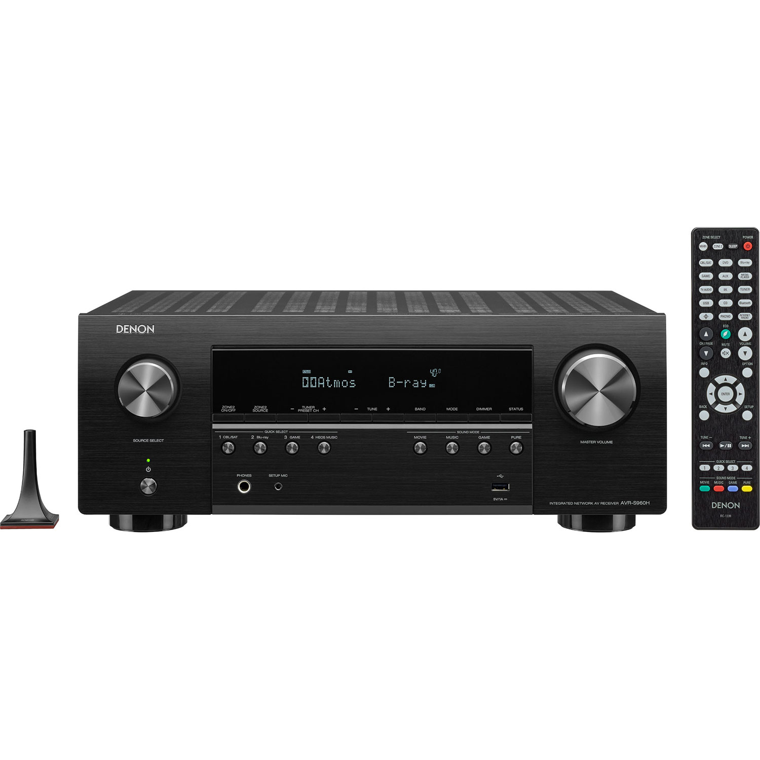

Looking for a suggestion for the AVR? Would like something w 4k 120hz also.

could I add a second sub? Also this is a 9.2 avr is that ok in a 5.2 system?

Denon, Marantz, and Yamaha are all quality receivers. I like the Audyssey room correction feature on the Denon and Marantz. I also like Denon and Marantz amp section

You have no avr now at all? The speaker placement being in ceiling for L/R mains is horrible, tho maybe good enough for your purposes. Denon/Marantz, Yamaha, Sony & Onkyo/Integra/Pioneer are the general go to mainstream brands for avrs; the Denon 960 would work well enough in 5.1 (and you can easily split a sub pre-out signal to multiple subs with splitters....all that Denon 960 has is an internal splitter for identical output on each pre-out; you'd have to go to Denon models 3xxx and above to get two separately adjustable sub pre-outs for level and delay). With all the changes going on with Onkyo/Integra/Pioneer might leave them out of it for a while.

Based on the receiver you asked about you have a budget. That receiver will be fine, check online and see if you can find matching def tech L/R speakers, looks like there in the $200 range (you could get four so you have five matching L/C/R and surrounds). You’ve already got your in ceiling speakers so you’re on your way to a 5.1.4 system. Also to save money a second Velodyne sub and flank your couch with them, it won’t pressurize your room but sitting between them won’t suck.
