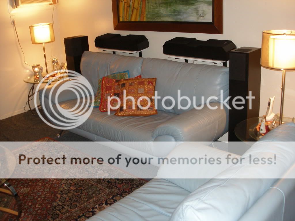

This was my rear section, with up firing rear surrounds. Did it work, yes. I did make some minor changes since then.
