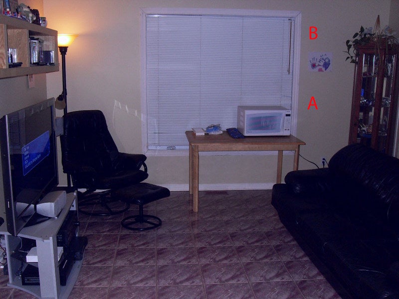

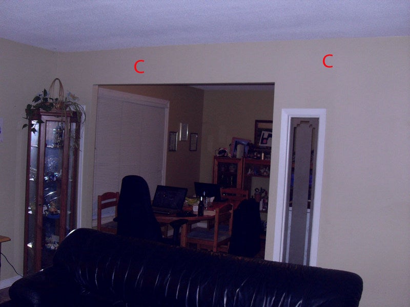

I would really appreciate some help / advice on speaker placement and whether to go 7.1 or 5.1

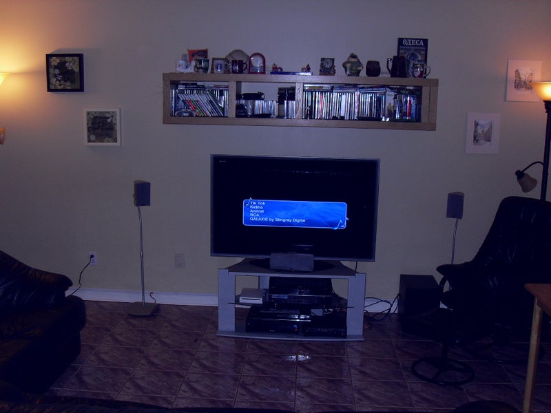

TV: Toshiba 47VZ650U Regza 47" LCD HDTV
AVR: Yamaha HTR-6063 (RXV567)
BRP: Sony BDPS570
Front speakers: Paradigm Cinema 70 v2.0
Centre channel: Paradigm Cinema CC v2.0
Sub: Paradigm PDR8 v.3

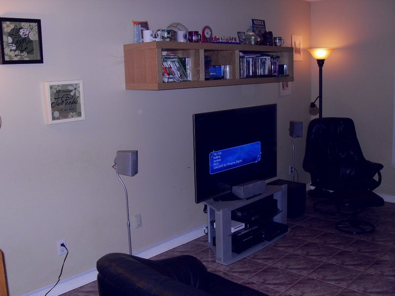

The old AVR was 5.1 and the surrounds were also Paradigm Cinema 70 v2.0’s, mounted on stands like the front, at the ends of the couch. It looked and sounded terrible, nobody liked it, not even me.

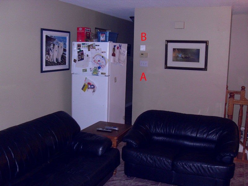

I have ditched the surround stands, and will mount the surrounds on the walls, running the cables through the walls. Originally I was planning on using Dolby recommendations, and planned mounting the surrounds 5-6” above seated ear level, using Monoprice wall brackets.
Problem – this put them in prime danger of being knocked off the walls by kids / dogs / me carrying something heavy.
So I jumped the gun and ordered some in-wall speakers – a pair of Speakercraft MT-TWO’s.

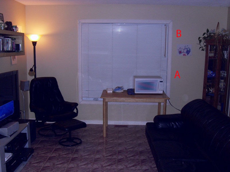

These were planned to be installed at locations “A” in the pictures.
BUT – I soon realized that on the right, this would mean mounting it in an exterior wall, with the attendant insulation, drafts, vapour barrier concerns that would bring.
Soooo – plan B is to go back to using the Paradigm Cinema 70’s for surrounds, and mount them using the monoprice brackets, but higher up, out of harms way, more like THX-type recommendations. This is shown by the B’s in the pics, as you can see from the pic of the left side – it’s a bit of all-or-nothing on the height, as the light switches, thermostat, etc. prevent an intermediate height option.
The question:
If this plan B isn’t soundly rejected by the experts (you lot!) – the question then becomes:

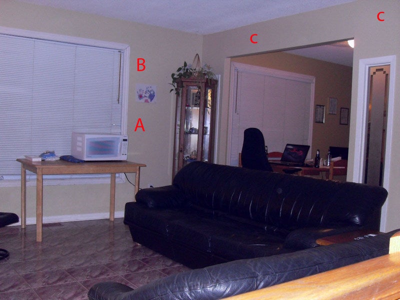

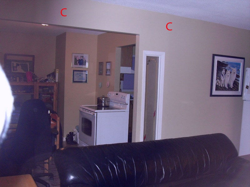

Would it be worthwhile installing the Speakercraft in-wall speakers as rears in a 7.1 setup? As you can see, I don’t have ideal space for this either, the most likely being up in the wall behind the couch, in the positions marked “C” in the pics. Would this be worthwhile or could it make the system sound worse than just sticking with 5.1?
The dimensions:
Assumed “sweet spot” = centre of couch.
Seated ear height – 38”
Viewing distance = 9’
LS (A or B) to ear – 11’6” – lateral distance
RS (A or B) to ear – 6’ 6” – lateral distance

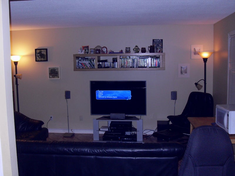

L&R mains – 11’ from ear / 38” high / 22.5” from edge of TV
Centre – 10’ from ear / 53” high / centred over TV (ignore the fact that it is shown below the TV, I am making a custom bracket to mount it above the TV and point it down a few degrees).
REAR WALL 3’ BEHIND LISTENING EAR.
Position A approx 43” from floor or 5” above ear.
Position B approx 73” from floor or 35” above ear.
Position “C” approx 7’4” from floor or 50” above ear.
PLEASE IGNORE THE KITCHEN TABLE, FRIDGE, AND STOVE – THEY ARE TEMPORARILY DISPLACED FOR KITCHEN RENOS (How did you think I got the new AVR and the spanking new SONY BDP!!!)

I'd try to help but the pics aren't showing up. I will say that the 6' height is preferred. If the Yammy has YPAO auto setup, you should use it. It'll help balance the speakers' output.

The Dolby recommendations are just that - recommendations. Do what works for you. If you go with them higher up, just make sure you can aim the speakers with the brackets. I prefer to have them closer to ear level, however that isn't very attractive or functional when mounting on the wall.

I wouldn't mind the rear speakers, but I'm not sure it would be worth the hassle, TBH. If there is no budget left, what you might consider is selling the inwall speakers as well as your Paradigms for an upgrade of the front three (or even just stereo) one day. A thought.
For now, tilt your center speaker upward, until it is ideally firing directly onaxis to your ears.

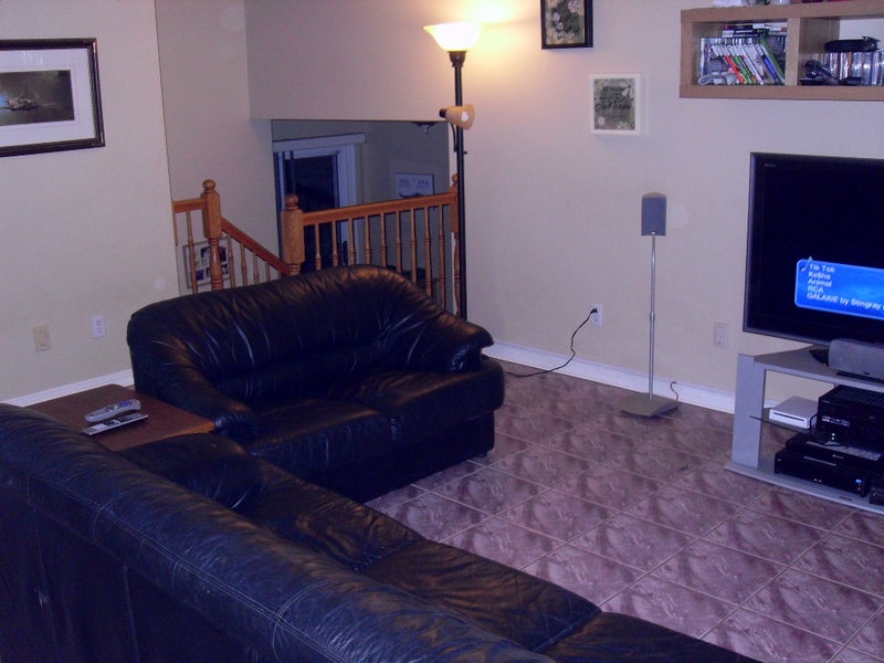

Ok, I would mount the surrounds in the "C" area (5.1), angled down some if possible, and about 9' apart. Also looks like the fronts are toed in a little too much.
For the Cinema 70s, the Bass cross over should be 120-160Hz.
Yes, it has the YPAO and I'll be using it with a tripod when I get the speakers mounted and wored.
Yea, it sucks when we have to compromise, but without a dedicated room that's usually the name of the game. Oh well.
To be clear, you mean do not mount any speakers at A or B, and mount the two additional CC 70's at "C" (i.e. stay 5.1 only, have the "surrounds" in the back, and do not use the in-wall speakers)?
Yea, the fronts are still geting knocked about during the chaos of the renos - shoud settle down and allow me to index them soon! :eek:
Thanks for the help and opinions so far guys.

(B) would be my pick for the surrounds & (C) ok for the 7.1 option, My Side surrounds are in a similar location, (maybe back a touch) and I use some speakercraft in ceiling speakers for my 7.1 (AIM8-3) which work great (better than I thought) & dont interfer with the decor
