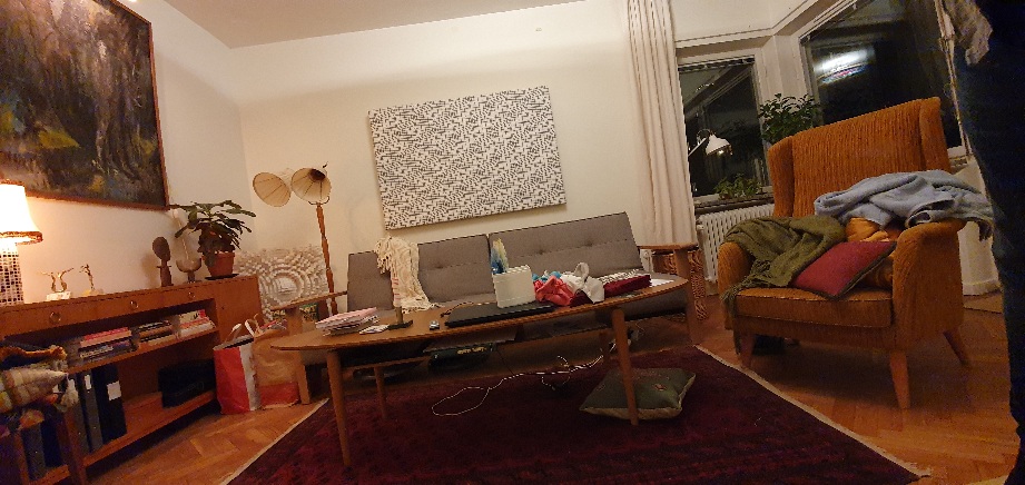

As you see, a sub optimal setup...
And wife approval is in a thin line...
Sorry for moving materials..

Hard to tell from the pic that there is that much room behind. 1.5M is doable for surrounds, but I might still skip 6/7.1 and go for Atmos instead. If it wasn't already the plan to upgrade to a new pre/pro, it can wait. So current AVR does not support it I guess is the issue?

Your place isnt really as bad as you think. There have been a lot worse rooms like mine!! The one thing I did notice is that you should pull your center channel away from the back wall so that the baffle extends past the edge of your equipment stand by a 1/2 " or a couple of cm. I would also pull out the towers from the back wall by at least a foot.
j_garcia
j_garcia
I don't think this room is that bad either. I have also had worse rooms lol.
I'd actually maybe get a small isolation pad and angle the center slightly up. Like this: https://www.amazon.com/Isolation-High-Density-Significant-Improvement-Vibrations/dp/B07DCQW156/ref=sr_1_5?crid=2GGDCR8M43FWO&keywords=moped+speaker+isolation&qid=1642608244&sprefix=mopad+speaker+isolation,aps,116&sr=8-5 Use only half to achieve the angle, either the thin one or the one with the lip. I do this with my center too because it is slightly lower than ear level.
Agree with pulling the mains out from the wall slightly, but doors on both sides, so I understand.
