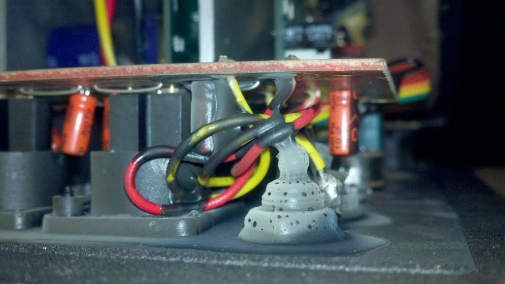

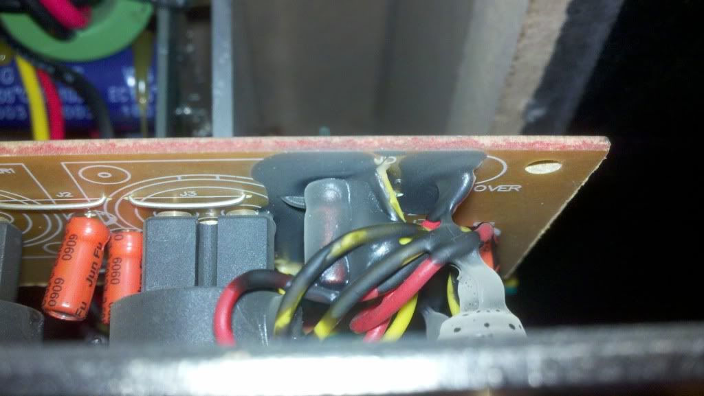

My sub amp when it died. Caps would be above and to left of the wires enclosed in silicone in first pic :

No, can't see your pics. You can likely post, but they won't show up until you meet some forum criteria. Should be able to externally host them via a photo share site.

May be blocked by work, I can't see it, will have to look later.
