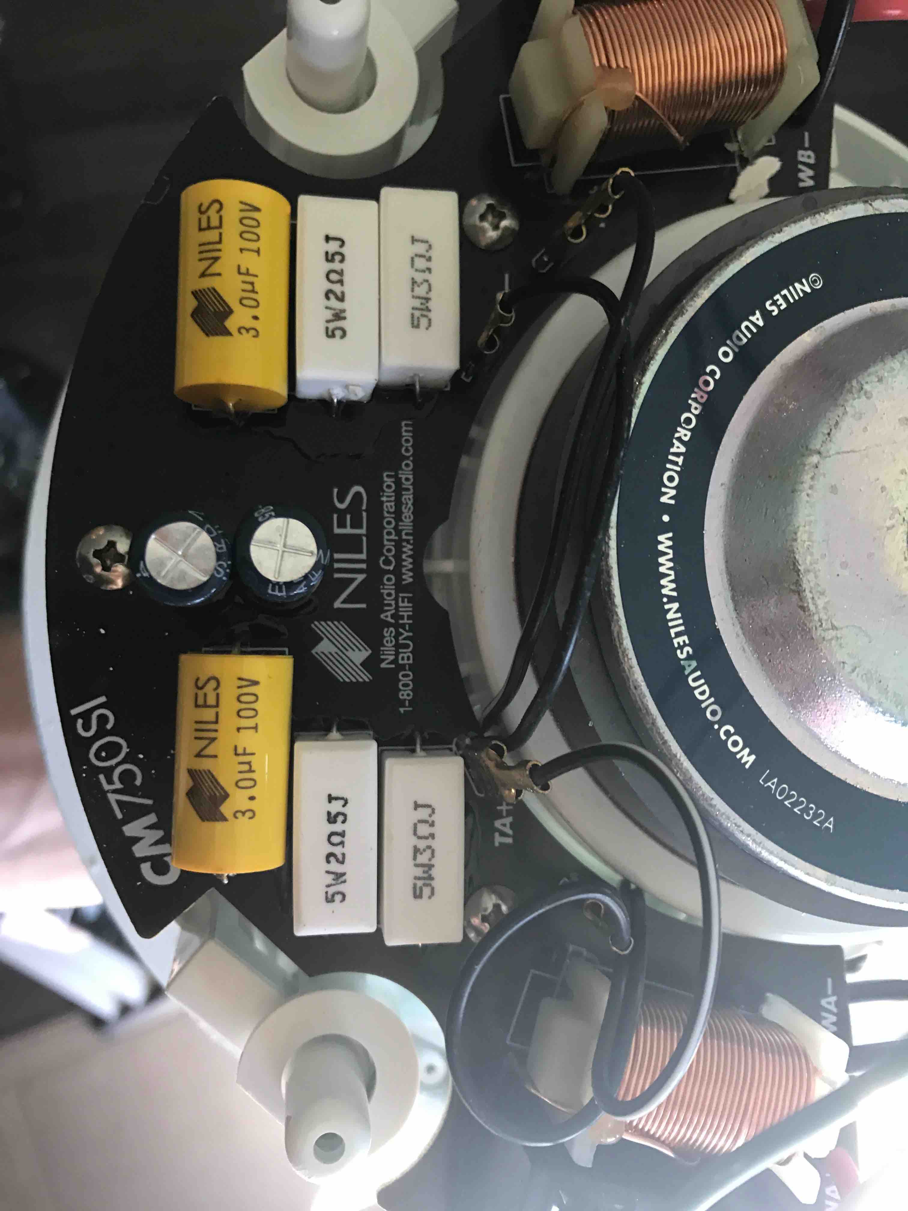

Alright, so I had time to take one out and it looks like it is a stereo speaker? Which is unexpected but alright. It's a Niles CM750si. All four wires definitely go to individual places. The Black and Red are next to each other and so are the white and green. I'll attach a photo! What kind of amp do I need to run three of these? A six speaker amp possibly? I've looked around but I can't find how anyone else is running these speakers...

Take a look at the speakers, each single speaker is "stereo" connected. It doesn't explain much in the literature I saw. The Niles SM750si brochure here https://www.manualslib.com/manual/299535/Niles-Cm750si.html
I'm afraid the OP needs to turn his excitement to disdain!
This is the abortion we are dealing with.
So we have dual voice coil woofers, with the coils connected via low pass filters to a left right stereo pair. We have two tweeters close by pointing in vaguely different directions connected to high pass filters fed from the same left right stereo signal. This explains the four wires to each speaker!
Unfortunately although nominally 8 ohms, the spec states the minimum impedance as 6 ohms. The minimum impedance is much closer to what the impedance actually is than the nominal impedance. So absent an impedance curve the best rule of thumb is minimal impedance plus 10%. So you have to regard the speakers as 6.6 ohms. It is tempting to put the speakers in parallel. However that would make a 3.3 ohm load, and may be less as we don't know the impedance curve. This is low enough to damage all but the most expensive amps.
The bottom line is that the designer of this speaker and the installer are perfect fools.
So this set up would require a six channel amp. You might get a poor stereo image under each speaker, but I doubt even that. This set up is absolutely not worth the expense of investment in a six channel amp.
It gets worse, as the two woofer coils are going to be fed different signals, and a lot of them out of phase. There will be electromagnetic induction between the coils with induction of voltages different from the driving voltage. This will get fed back to the amp via the speaker wires. These voltages will be fed back through the amps negative feedback. The amp will therefore try to vigorously oppose these signals different from the amps output. This is highly likely to result in amp destruction.
You can never assume that just because a product is made and marketed, that it is any good, and safe to use. This product is totally ridiculous and I suspect has totaled at least one six channel amp and may be more.
These speakers need removal and given a decent burial at the recycling center. Under no circumstances, should any attempt be made to use them.

Just to confirm--You are saying the woofer is dual-voice-coil, and by design, you are supposed to hook up the left channel to 1 VC, and the right channel to the 2nd VC on the same woofer?!?!???
I think that is what you said, right?
But, I can't even begin to fathom how that could possibly work!

You are correct and it is insane.

Single Speaker Stereo is a common product from most of the higher end in-wall/ceiling speaker manufacturers. It is used to increase the sound stage without the need to make additional holes in the ceiling and is most commonly a design recommendation for bathrooms, closets, hallways, and laundry rooms. It is not common in a kitchen or dining room or other large space, but sometimes is used.
They should be addressed as a standard stereo speaker pair. So, while it appears to be 3 speakers, treat it like 6 speakers, which means a six (or high) channel amplifier to run them as standard audio distribution.
