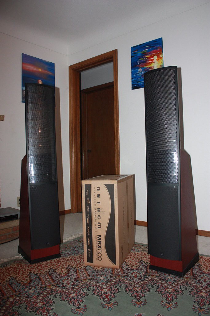

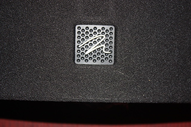

Here are the twins.
The carboard box is a loaner, that I have yet to open.

Oh I almost forgot, congrats on the speakers. What model are they? They will be part of an HT/mch rig, or as a stereo set?
dem beats
Josten, you are the man. Chicklets to come.
They are the purity. Hency why I don't actually need a robust amp to drive them. I can just line them with RCA's.
As for where they go... stereo in the living room. For the W, but now I'm feeling a bit "jelly" and want to have them in the HT.

Ah, fully active, how cool. I vote for stereo, with anything that works as dedicated pre/pro. :) I suppose the room and layout has the greatest say in that kind of decision.

I am confused, dem beats. You don't need amps, do you?
You should look into your hybrid speaker design, and how that reacts with Audyssey or YPAO. There might be some phase issue, as essentially half your speaker is dipole (they might have the woofer out of phase on purpose? oh I hope I don't worry you for no reason, I could be way off there).
I also think the value of an Audyssey purchase declines with the fewer speakers there are, and two speakers would be pretty much the minimum.
I guess I'd look for SNR specs and such, between the two, and I know Yammys are supposed to have very clear preamp sections. Electrostats are extremely revealing IMO.
Please play with placement, big time, and particularly with space from the front boundary, as well as possible absorption on front wall.

Amp is built right in so no I don't need amplification. I can power it through an amp however. Many reviewers found that there is a difference between the two methods. I haven't spent enough time A/Bing that theory to be sure.
They are revealing. It's almost hard to listen to poor recordings and some compressed music. For SNR the yamy's both list 100 DB and the marantz lists 102. THD is a bit more in analog on the Marantz but I am thinking it won't make much of a difference.
The "need" for a new AV receiver stems from the W wanting one, and she refuses to entertain the zone 2 option from the z7. She can then plug in her Ipod, laptop, PS3, cable box, CD player, and now apparently she found some records she wants a turn table for. Yeesh. I require it to be a networking device, so that's the reason I end up looking at the higher level gear.
Everyday I re evaluate the speakers position with put raw left and right source. From the laptop or CD, with no receiver or amp in the way. This is THE biggest factor for any speaker IMHO and it's just made that much more apparent with the Logan's. I got the go ahead from the W to put in some room treatments also.
