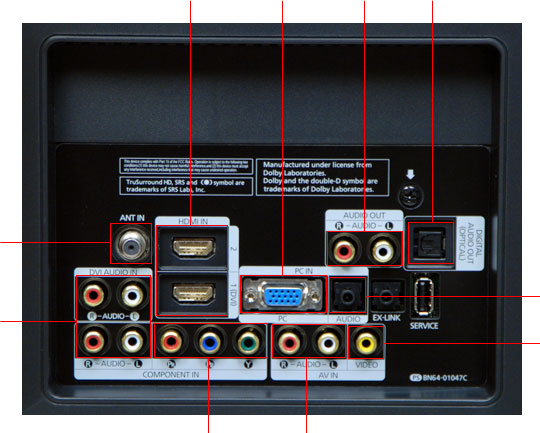

Here is the back of my tv, Samsung LN32B360. Nothing special I know, but I still wanted to get decent sound somehow. So, there's an RCA audio out, or Optical. I only have the coax cable plugged in.. Are there any receivers where I'd be able to go straight coax in?
I'm really confused about what my options are.. sorry! Please help! haha

No, an integrated amplifier has a preamp section so you don't need anything in between. A stereo receiver might have video switching as well, but integrated amps typically do not.
I believe that is the same TV I have in my second system. You simply connect the R&L stereo outs to any stereo input on the integrated amp and it will work. I use my Marantz PM7200 integrated in my second system: http://forums.audioholics.com/forums/showpost.php?p=681615&postcount=30

I stand corrected, I glazed over the word integrated and saw only amplifier. An integrated amp will work.
