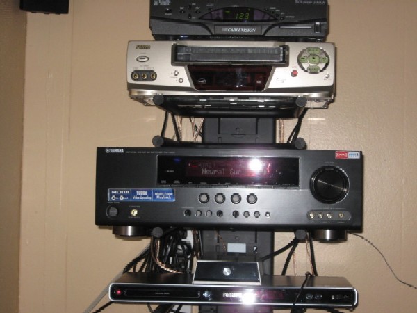

I use banana plugs on my other setups, just not here... No joke, it took me about 20 minutes to wire up the receiver with 7 speakers...:eek:If I had the room, I would have used banana plugs in a heart beat. That picture of the wall mount is my setup..
