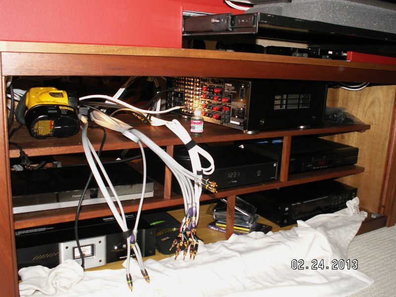

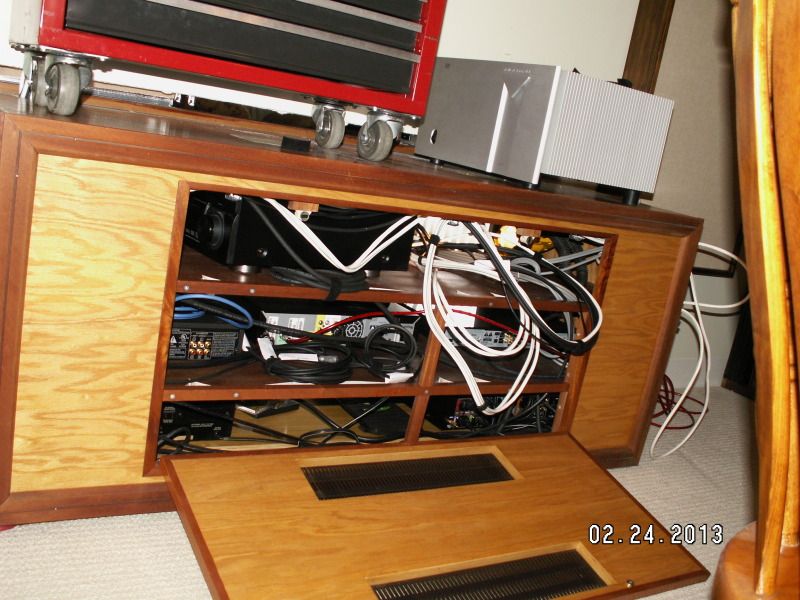

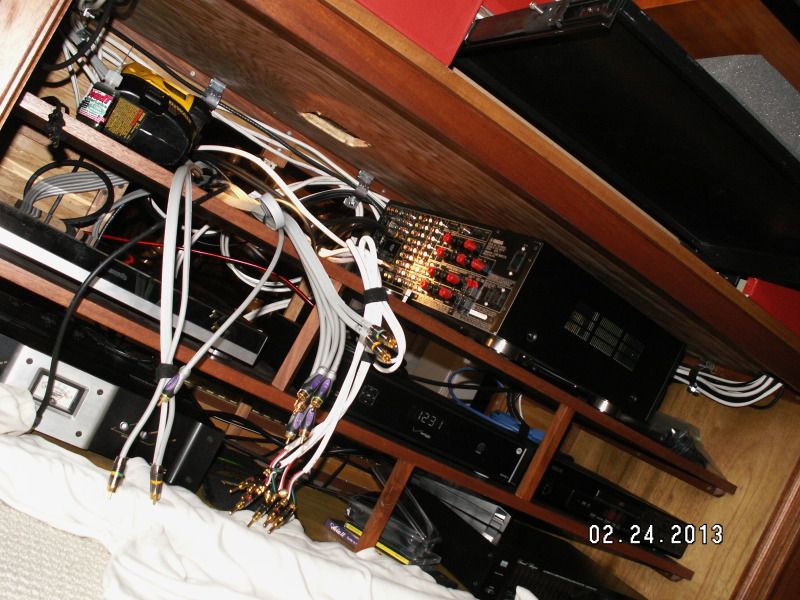

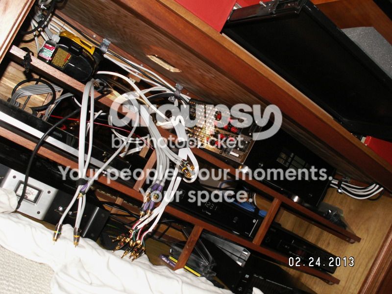

    Holy smokes do you ever know a lot of vague stuff about rec'rs in general. That splitter would just require a bunch more HDMI cables. I can get that same DD or DTS signal across fiber optic or coaxial which I have plenty of laying about. Good call on the audio out from the TV. Mine's a THPZ77U I believe. My TV only has 2 HDMI 'ins' so I have the BR in one and the switch (which also serves to pass through the 720p/1080i cable signal) plugged into the other. Both HDMI cables are fancy BJC jobs. I'm not going to have the rec'r handle any video but just in case there is a composite and component wire set going through the wall from the entertainment center to the TV.
    I had to come find that for the 8 channel ins you have to use the DVD ins for the R&L channels. That's wild.

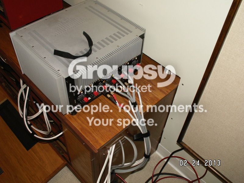

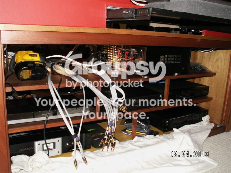

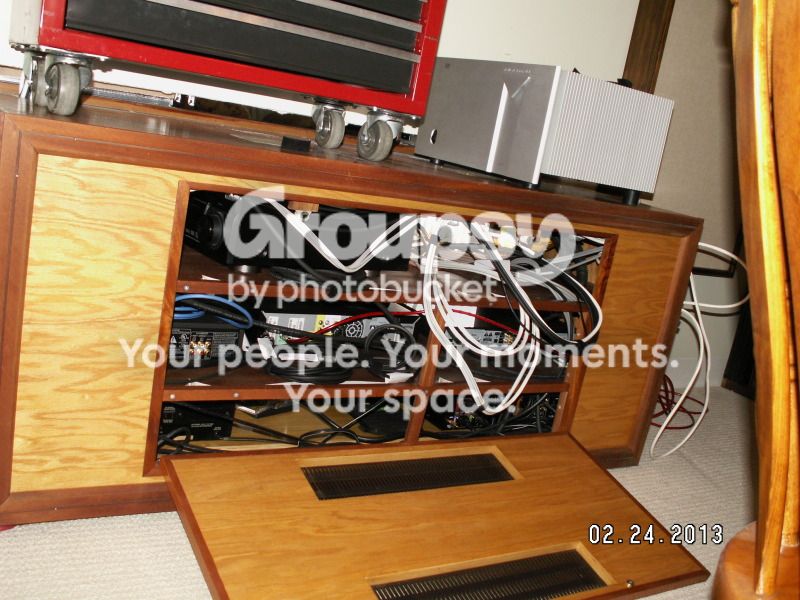

    Anywho, here's a couple of pic's of wire mayhem but I want everyone who has to suffer trying to wiggle fingies in behind the back of gear that this is a much better way.
    ManTown side:
    [​IMG]
    [​IMG]
    Living room side:
    [​IMG]
    [​IMG]

    Reading this and seeing the photos (were you ever able to close the rear hatch with all the added cables?) has given me painful flashbacks to when I installed my Panasonic BR player. Getting the HDMI cable from the BR player to the TV was a piece of cake, but it was a nightmare getting those 6 RCA cables between the BR player and the non-HDMI receiver hooked up correctly.
    Just when you finished installing that custom-designed HT cabinet and getting all your gear wedged into it, you had to get weak and add that 7 channel big-iron amp which we all know you don't really need :rolleyes:. How long did you spend thinking about that custom design making sure it was "future proof" :D?

    I did get the wires routed a bit better and it does close. My wiring woes although considerable are nothing compared to how it use to be. What do you mean I didn't need that amp? I sure hope you don't get put on forum probation for saying that. The reason for the rec'r swap was that the monitor out failed on my previous H/T rec'r and I couldn't pull up my OSD without which there is no setting the individual channel gains. I had it working and I think it may just be the jack at fault but at this point I wasn't about to investigate especially while I had the 2600 in ManTown. Short changing the living room in any measure is unthinkable at this point. That's also the reason for the Aragon 2007. The Yamaha RX-V2600 and 2500 for that matter do poorly with a 4 Ohm load. I mean they would do well enough for normal use but what about when I want to show off? You should know by now that when I give, I give till it hurts.

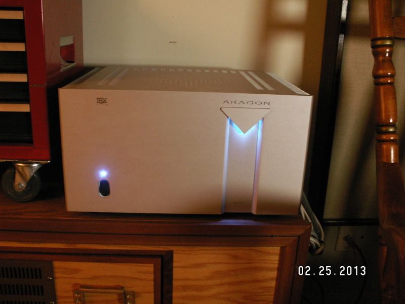

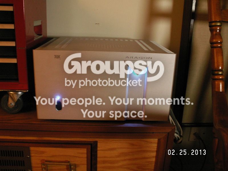

    I will admit that watching Sinister and having this amp push those speakers during the parts that are suppose to make me jump was quite a bit of fun. Then I saw Adele do some tune for Sky Fall on the Oscars I believe. You know what else is cool? It turns on and off with the rec'r. For me that level of automation is like up there. Anyway, here's the pic taken in low light so you can see the blue. Not bad, huh?
    [​IMG]

    Awesome amp!
